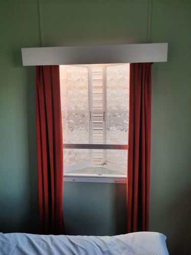

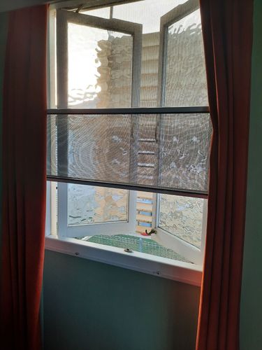

I made flyscreens for my casement windows a couple of years ago with a fixed top section and hinged lower one to be able to open and close the windows. You can put the hinged section as high or as low as you like. I have more details on how I made them on Bunnings Workshop here
I couldn't hinge above my sink because the tap was in the way, so that section is held in with swivel clips top and bottom and I just lift it out when I want to open or close the windows, most of the time they stay open anyway.
20251015_054001.jpg   20251015_053102.jpg  20251015_053902.jpg  20251015_053617.jpg
