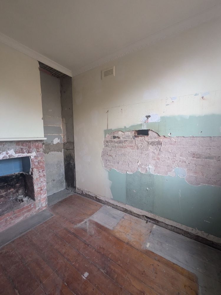

Hello community,
I am renovating a kitchen and had the demo guys strip out the old kitchen and tiles. The walls need to be rendered again and I am trying to look for a renderer to help.
Question, I see many people on Airtasker who work with plaster boards and plastering/patching plaster boards. Is what they use to render different when compared to a brick wall? What render should they be using and will they be able to carry out the job if they are experienced only working with plaster boards? Image for reference.
Hi @bhushan154 sorry I can't really help, from what I understand it's different to plastering, no reason they couldn't do both but it would be up to their skill set. Looks like a fun project!
