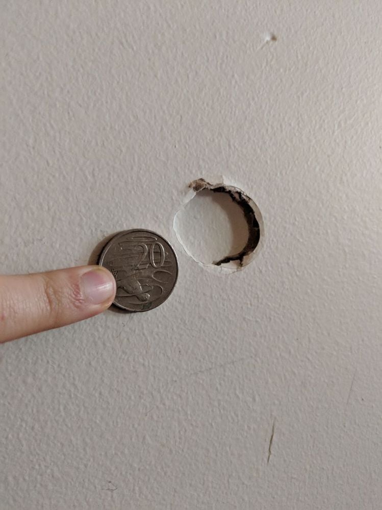

Not long ago a friend tripped in our hallway while wheeled his bike down it, leaving a handle bar shaped dent in the hallway plaster ๐Ÿ˜• We have a house inspection coming up soon, so I am wanting to patch the hole and looking at options. I have gotten a couple of quotes from tradies, but they are asking a fair chunk of cash including time and materials for a very small project, so thinking I might be able to do this myself and learn a new skill.
My main question is the cost of materials, particulalrly the colour matched paint. What is the smallest amount I can buy and rough price, possibly a sample pot, as I think this would be the biggest expense. After that I'm sure I can find a YouTube video on the process. If anyone has any advice, that would be appreciated!

Definitely do it yourself @Fendogz. You'll be fine. I reckon only an hour or two of your time.
Shopping list for you:
Little tub of filler - $6 - https://www.bunnings.com.au/earl-s-multfill-ready-to-use-filler-0-140kg-white_p1661244
Paint scraper - $4 - https://www.bunnings.com.au/uni-pro-75mm-carbon-steel-filling-blade_p1670148
Paint roller kit - $10 - https://www.bunnings.com.au/monarch-230mm-pro-renovator-all-purpose-roller-kit_p1661273
Cutting in brush (optional, but makes things easier for getting a great result) - $11 - https://www.bunnings.com.au/monarch-50mm-cutting-in-and-framing-synthetic-paint-brush_p1660278
Paint - $30 - https://www.bunnings.com.au/taubmans-low-sheen-white-easycoat-interior-wall-paint-1l-low-sheen-white...
I'd suggest not getting a sample pot but something like one litre so you can do the entire wall. That way the paint match doesn't have to be absolutely perfect and you'll never be able to tell where the hole was. If you can dig out the indent then you could take that bit of plaster to the paint desk for colour matching.
Hope that helps.

+1 to the DIY approach.
Just make sure you get a big enough sample of the wall colour for the colour match. That 20c sized hole might not be enough. You might want to cut out something a little bigger.

Thanks for the reply and detailed list Marty. I reckon I'll give it a go myself. Not too sure if I'll go for teh full wall option, as I live in sort of a long skinny house so that wall is almost the length of my whole place!

I recently had a very similar problem, only we were moving out. The ready to use filler, is very simple to apply, & mine came with a plastic scraper attached, so no need to buy a paint scraper. As thereโ€™s no paint matching service available in our small town, I went & got about 4 or 5 paint sample cards from our local hardware, that I thought were a close match to the wall. I took them home & held each of them up to the wall, in as much natural light as possible. After filling the hole, letting the filler dry, I sanded it back with medium, then fine sanding blocks. I applied the paint then, & when it had dried, found it was near impossible to see where the patch was!
