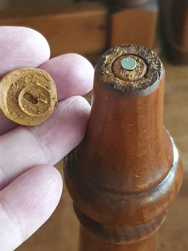

Thanks Mitchell. Good to know about the Selleys epoxy product too as the silicon putty did not hold up as a chair foot.
Due to the chair leg ends experiencing a fair bit of abuse, you might like to replace the tip with a nail on slide instead of the putty. They would be a more robust option.

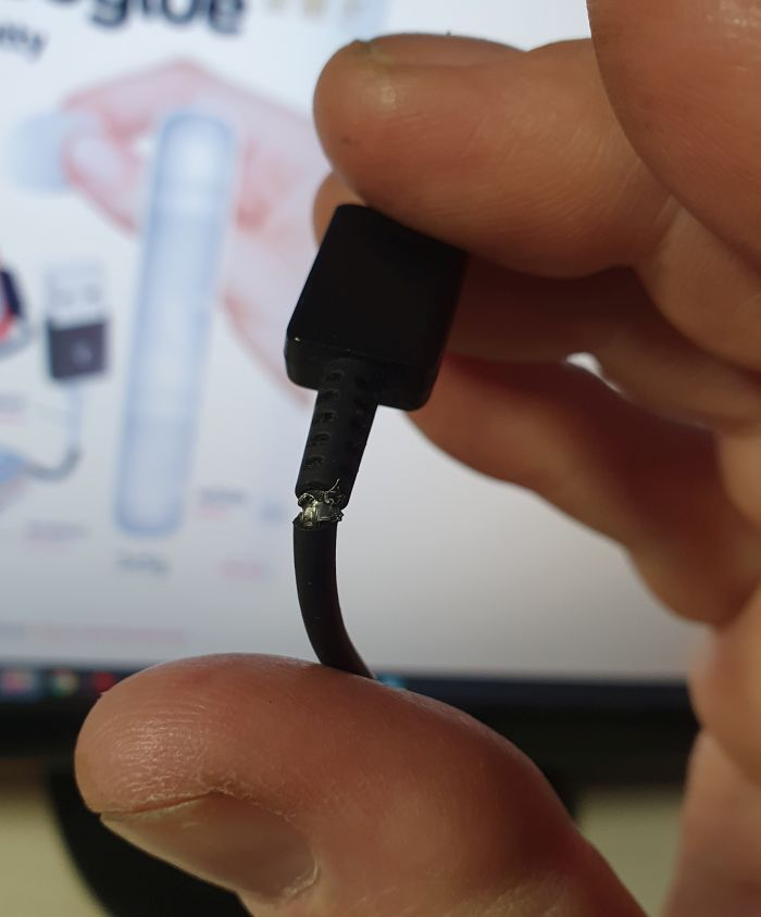

Certainly an interesting looking product (Kintsuglue) - never heard of it before, but just bought a packet from Bunnings and gonna try it on this cord...
Why do they make this area so weak?
Hi @Noyade , my cynical response to that question is - so they can keep selling products. Don't want them lasting forever.
But, less cynically, the interface between any material types, or even a significant change of thickness of the same material, is inherently a mechanical weak spot.
I always reinforce those places on cords wherever possible from the start. It's ok when I make the cord myself - I can slip on some heat shrink and taper the interface so it is a gentle change in thickness at each point, but trickier when it is an already made object, such as earphone cords.
I have had limited success by splitting some heat-shrink (that will fit over the thicker part), applying a thin strip of soft glue at the join and wrapping the heat-shrink onto that. I then shrink it to fit at the thinner part of the cord.
But it doesn't last all that long and also is a bit messy looking. Hopefully the malleable glue will be a more successful answer - for both of us.

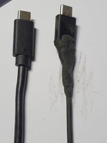

My wife laughed at my efforts to repair the cord with this mouldable plastic saying for a dollar more I could have bought a new cable. Probably right and my result looks aesthetically poor - I failed plastiscine class in Kindergarten. I noticed it also marks things easy - note the paper background.
Nevertheless it feels sturdy, well adhered and flexible. See how we go.
Incidentally, I know you can buy reasonably priced cords that are thicker (more durable?) from Kmart - seen on the left.
