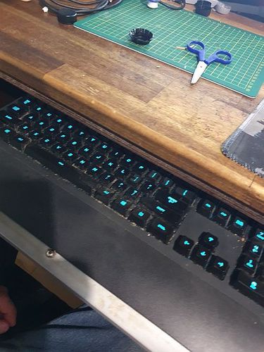

Below is a computer desk I made for my youngest son from one of those panels Seannami mentions above. It's had a solid 10 years of use/abuse and stands up well - I'm impressed with these panels. I think from memory I just used Linseed Oil.
I routed round edges - and again, they've stood up well over time.
Were you thinking of aluminium angle on the edges?
Dirty keyboard
