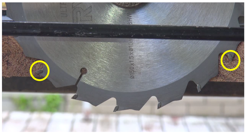

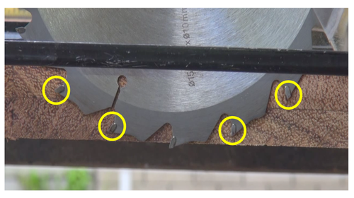

When selecting a new blade, look for any wording like "made for cordless saws". These will have a thinner kerf (thickness) with improved heat expansion slots, which result in increased runtime of the battery.
As @JacobZ, the general purpose blade usually around 20-24tct (toothed) is perfectly fine for general cross cutting and rip cuts. When performing cuts on splintering type timbers like plywood or you want a cleaner cut on other timber, then a 40tct will be ample. Though a 60tct will produce an even finer cut, personally it would be very rare to make that fine a cut with a circular saw. Thats when the mitre saw comes out when the cut itself also needs to be precise.
Any time cleaner cuts are needed regardless of blade, making them with the material upside down will reduce splintering on the good side considerably. Thats because all saws cut from the underside up. The other tip is to adjust the height of the saw so that the lowest tip of the blade is about 5mm past the underside of the material. It puts more teeth in the material with less friction. Always make sure the power disconnected/battery removed when making any adjustments.
Screenshot 2025-01-12 at 1.48.29 pm.pngScreenshot 2025-01-12 at 1.48.21 pm.png
