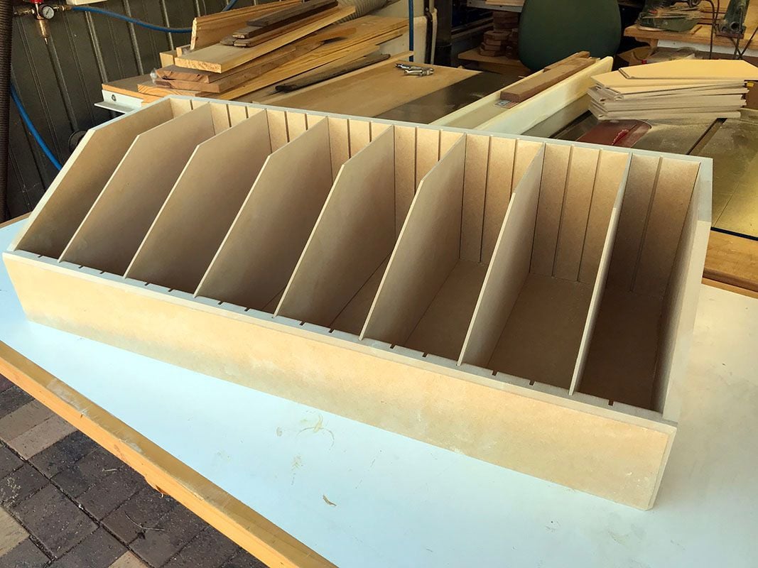

I saw a need at work to for a better way to store and display drum sander sandpaper rolls. They are an awkward thing to display in a tidy fashion because there are so many different lengths and grits.
I made four of these bins. Each is approximately 800mm x 350mm x 200mm. They will sit side by side for a total width of around 3200mm.

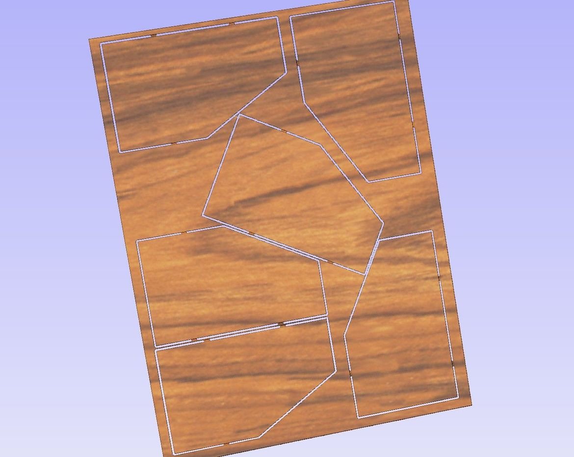

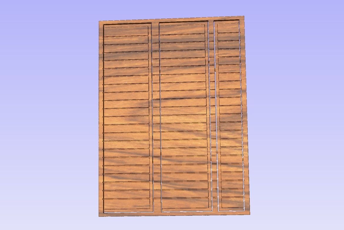

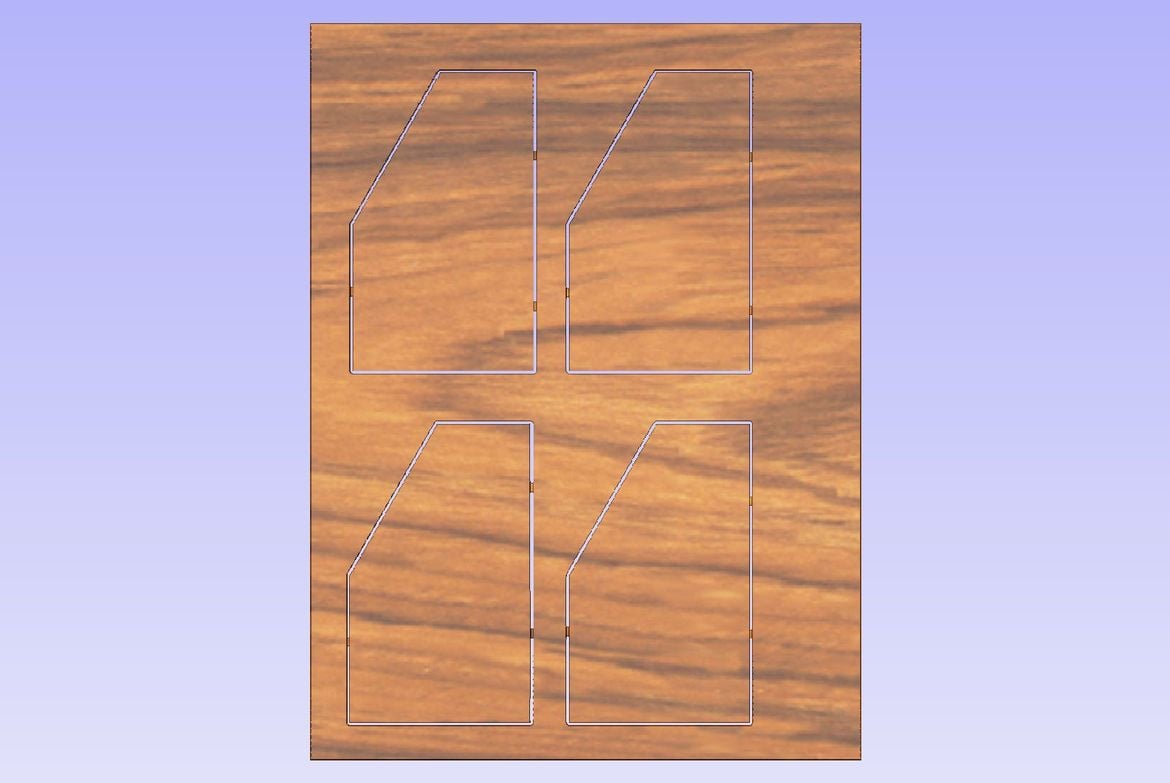

I designed and cut all the relevant pieces using my CNC machine: Four fronts, four backs, eight sides and 36 dividers using MDF in 18mm, 12mm and 3mm. I cut the base panels in 12mm MDF on my table saw.

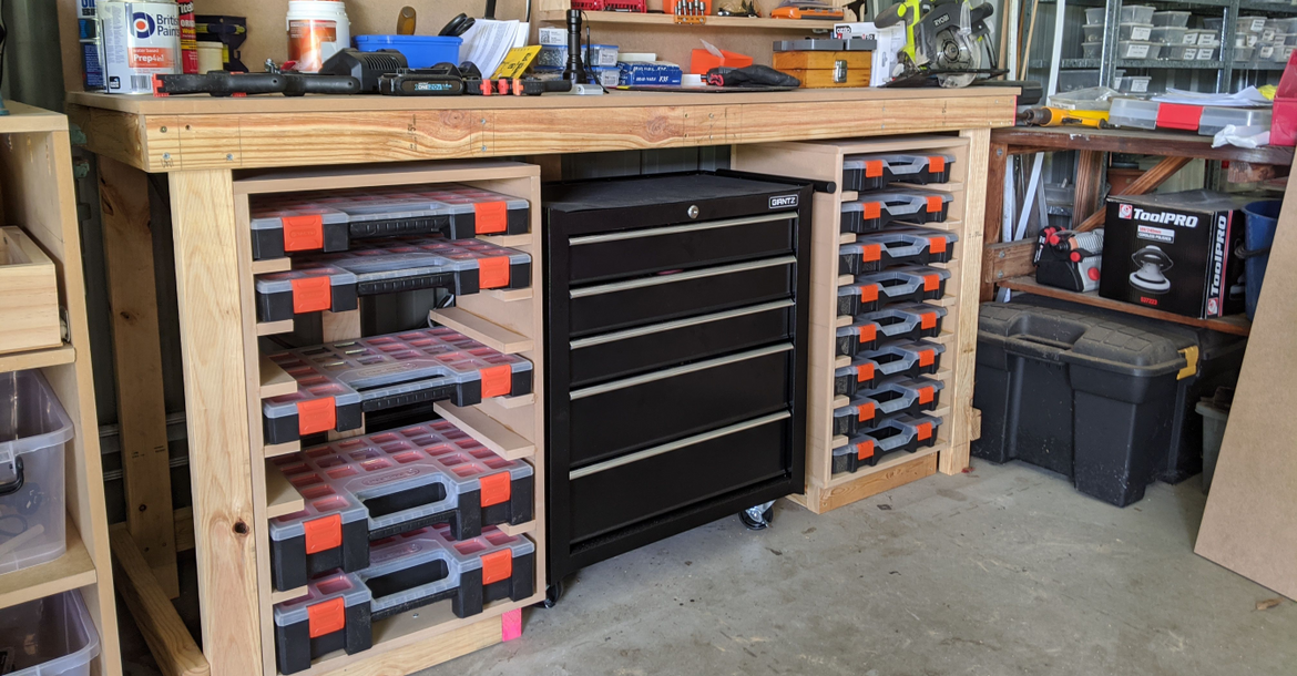

Bunnings Workshop member fhk56 made these custom timber storage units to hold fasteners, fixings and small tool parts.

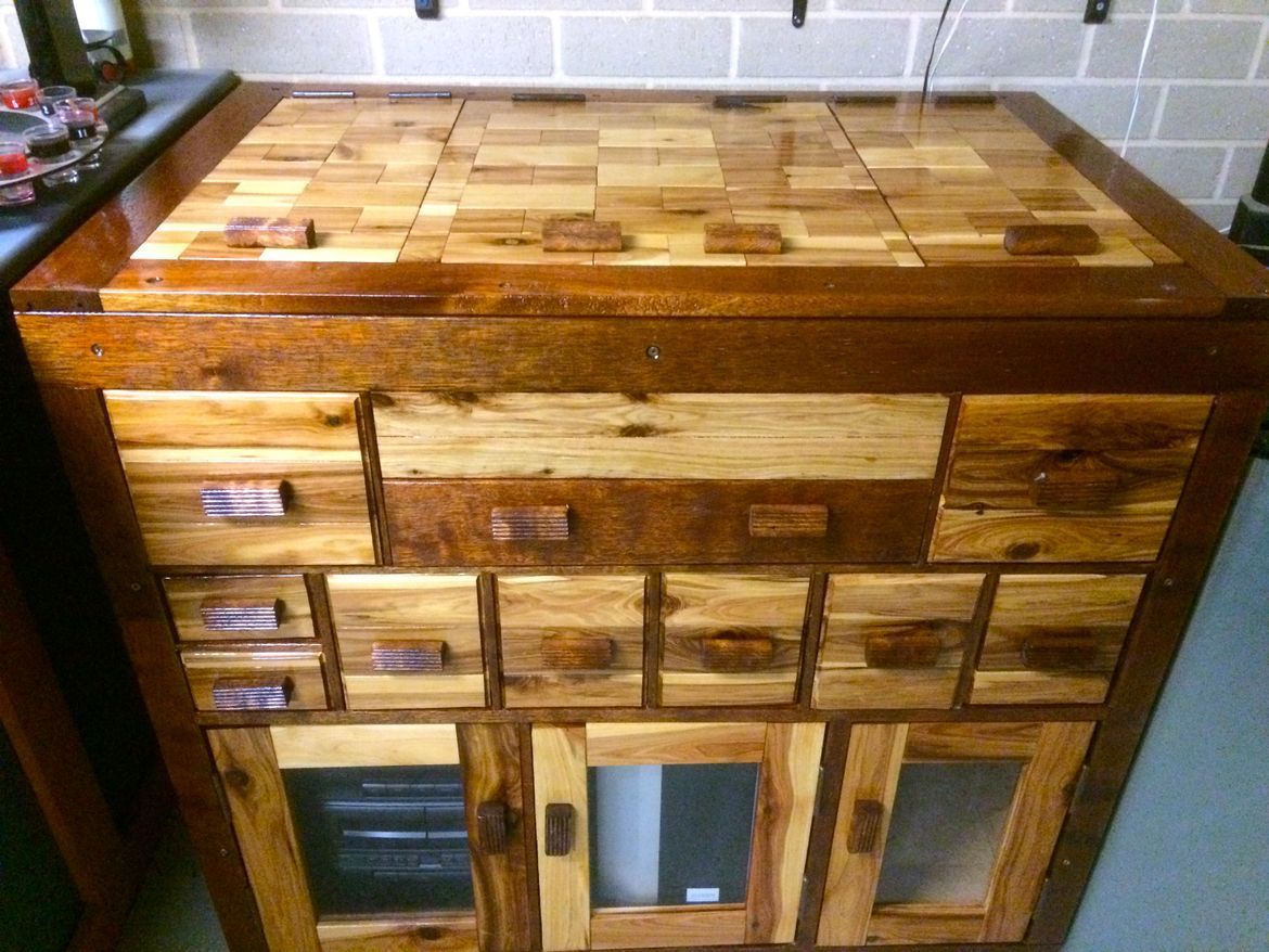

Workshop member kel used scrap timber to make this striking custom storage cabinet containing drawers and cupboard spaces of various sizes.
