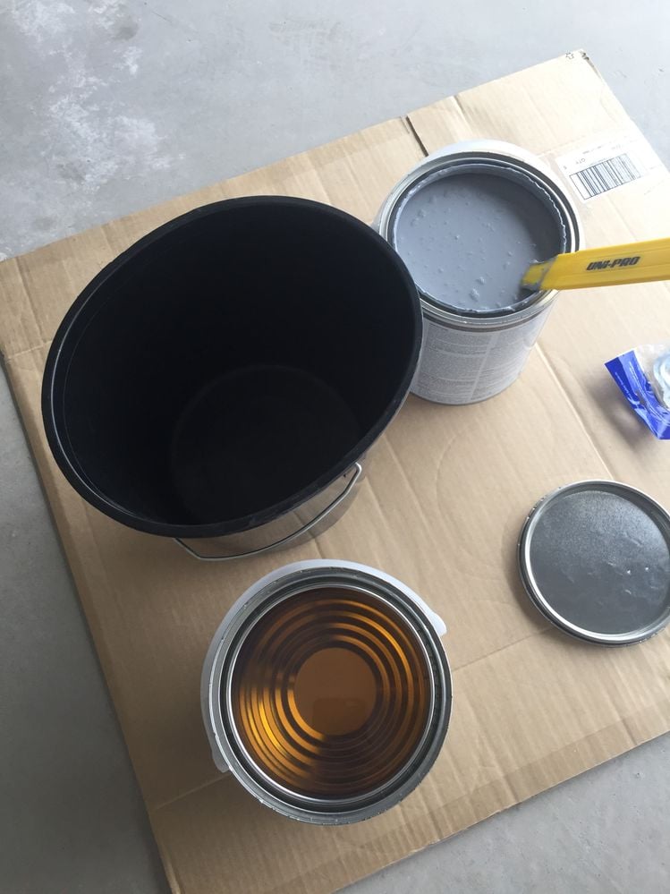

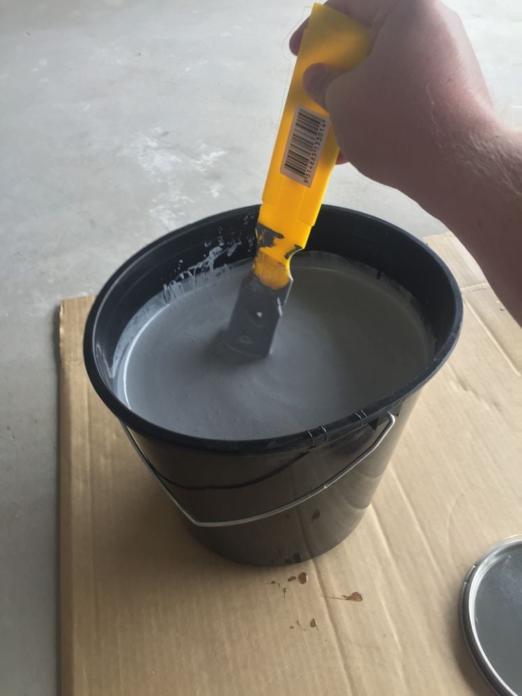

Once the floor was all prepped I began the process of the mixing the contents of the epoxy kit. Due to the temperature on Good Friday (below 15 degrees) I had to mix the activator and the base for slightly longer than the recommended 8 minutes and the resting time was recommended at 25 minutes so I left it for 30 minutes just to stay on the safe side.
