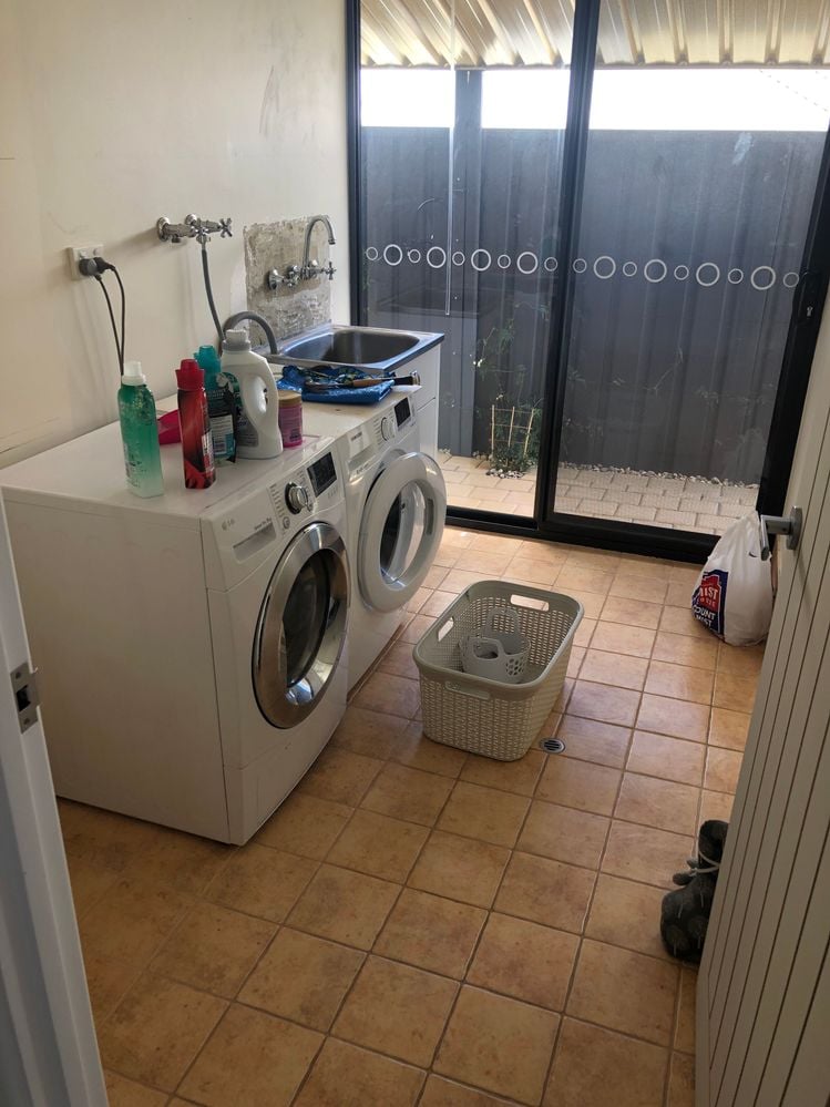

The laundry was as basic as you can get, with a laundry trough mounted in a single metal cabinet. At some point, someone had helpfully shoved a pantry unit in there to help with the storage issues!

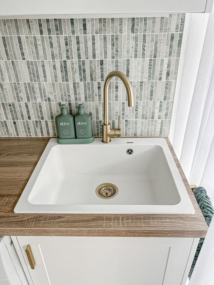

I had a wish list of laundry goals – bench space for organising the washing and the drying, cabinetry for much-needed storage, a large sink, and tying in functionality with form. The main thing was that it had to look good so that I would enjoy doing the laundry and spending time in there! We have a busy life with two teenagers and two dogs, so there is always plenty of washing. Why not do it in style?

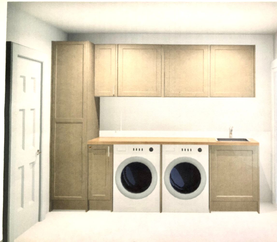

I spent a lot of time perfecting the design on the Kaboodle 3D design planner. It was a great visual aid and I found it very user-friendly.

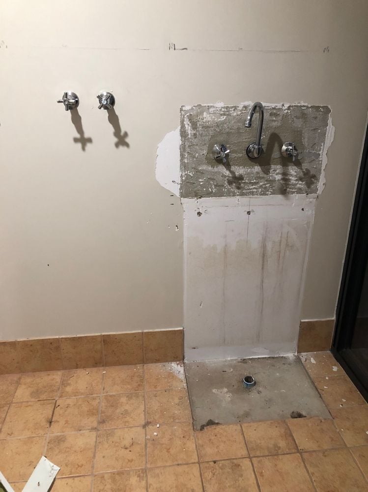

Once we had a plan it was time for the demolition.

Aside from the plumbing (moving the taps and washer connections) and electrics (moving and adding power points), my husband and I painted, built and installed everything ourselves. We're pretty handy but we had never done anything on this scale before!

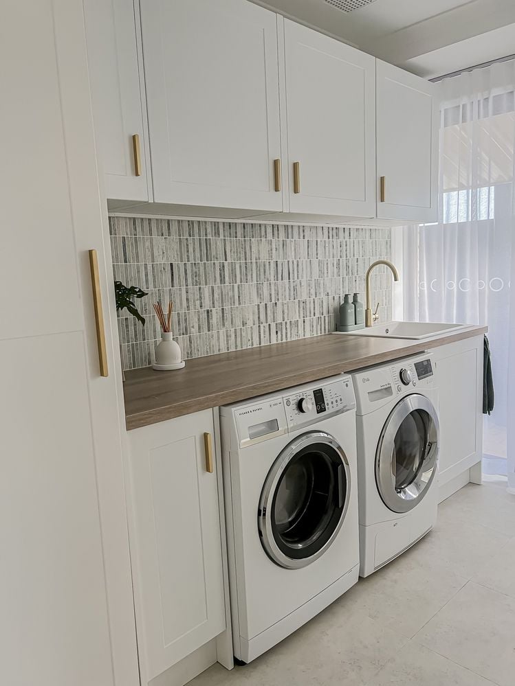

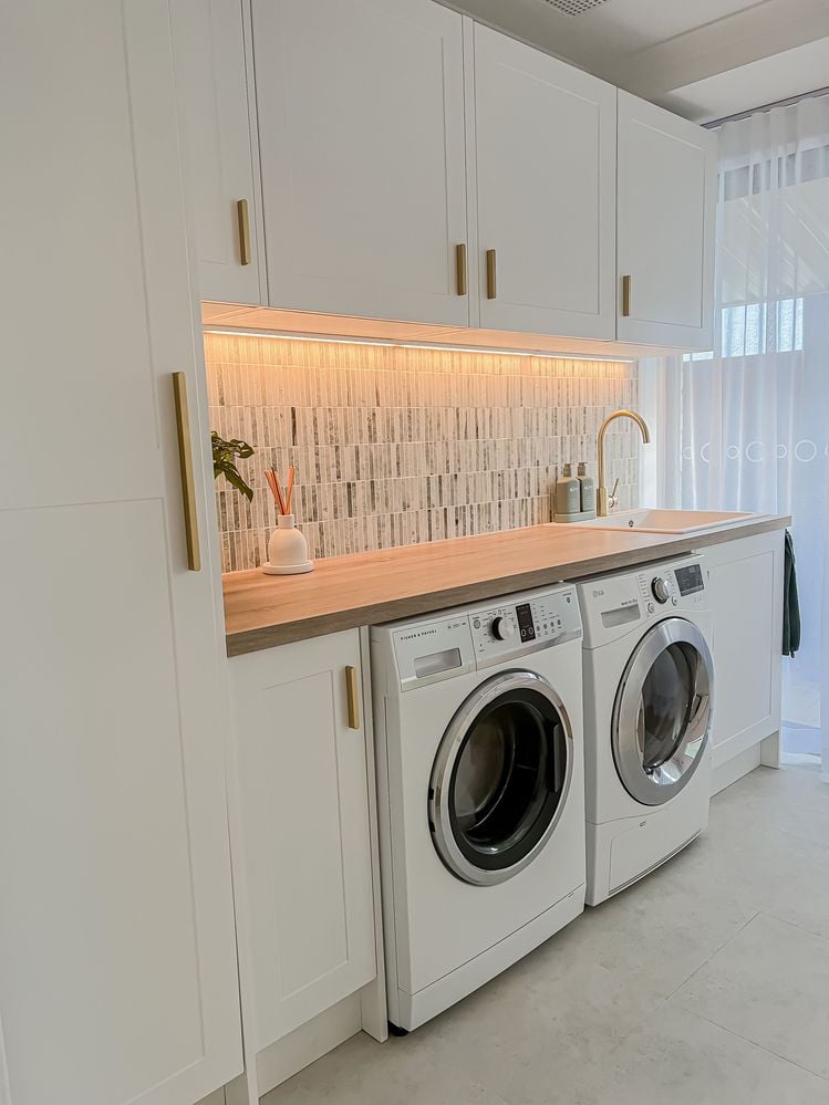

It’s amazing how much lighter and more airy the laundry is now. We're pretty thrilled with what we've achieved.
