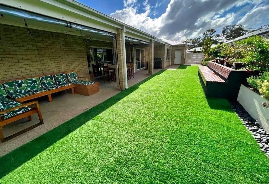

A comprehensive backyard renovation including raised garden beds, Merbau fence screening, outdoor seating and synthetic turf.

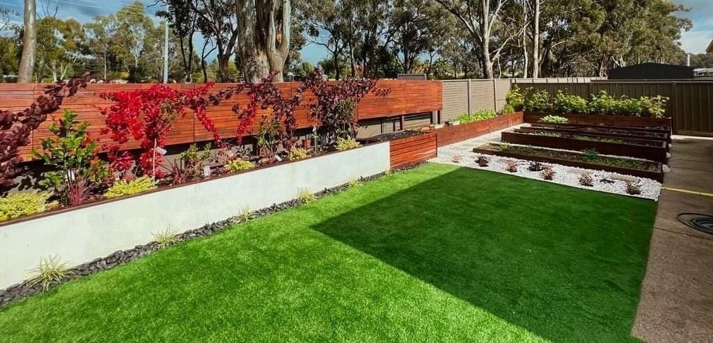

The project

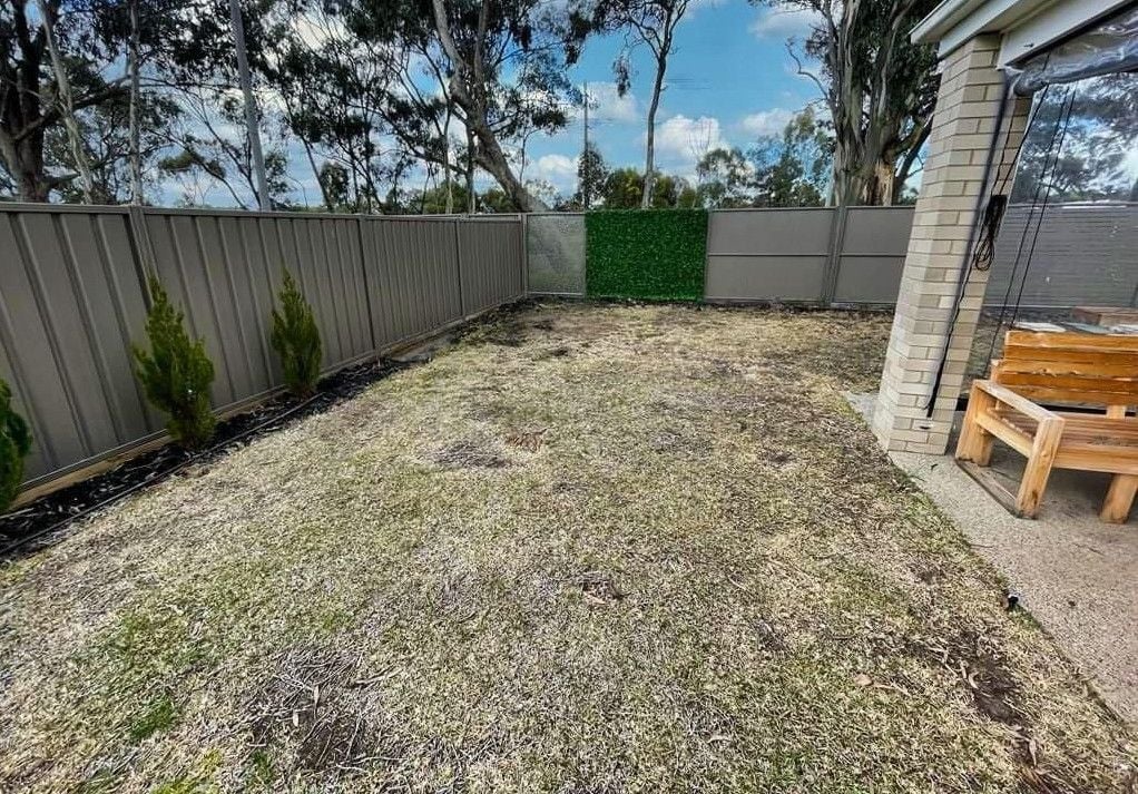

We already had a good covered space for entertainment, so I wanted to make some uncovered outdoor seating.

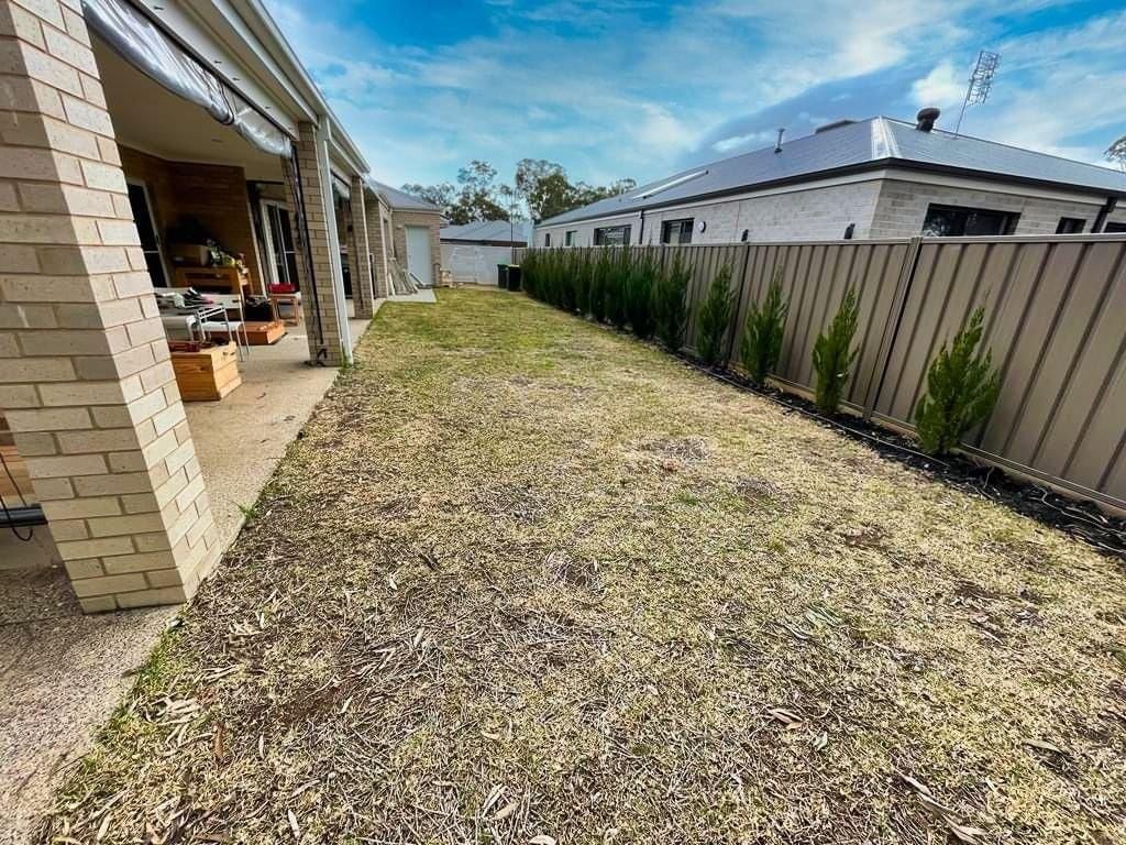

We had buffalo grass before and it was not growing as it should. The soil wasn't great underneath and big gum trees next to the boundary were not letting it grow. I spent almost a year trying to revive the grass and in the end decided to go with artificial turf.
I completed this whole project by myself.
Step-by-step
Here's how I went about it:
Step 1
Checked with council regarding screening height requirements. Made a Dial Before You Dig enquiry to ensure no utilities were present in the ground.

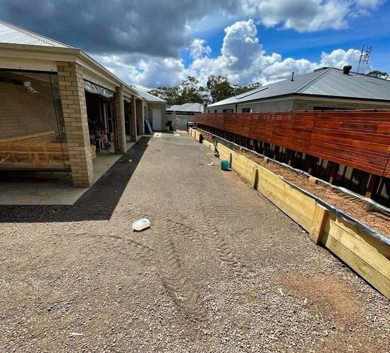

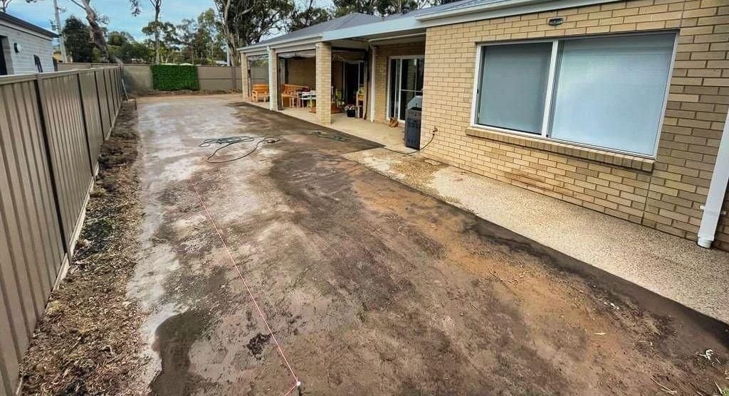

Step 2

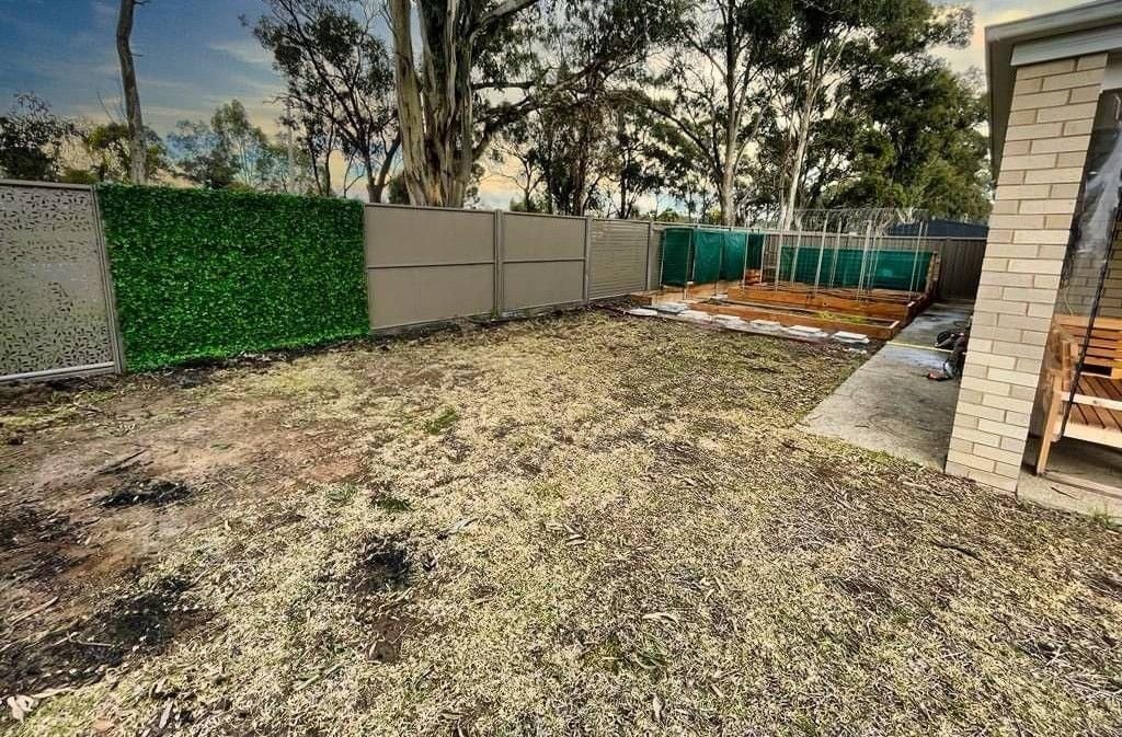

Removed the old buffalo turf and later used it to fill the bottom half of the raised garden beds. Hired a Kanga mini loader to clean up the yard.
Step 3
Prepared the base for artificial turf: an 80mm layer using road base and then the top 20mm using crusher dust. The ground was graded properly so I followed it without digging much. I checked ground slope requirements throughout and used a plate compactor three times to ensure the base was properly compacted.

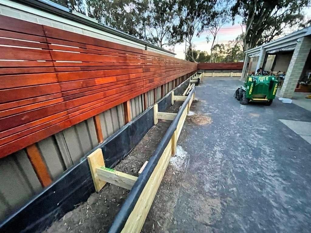

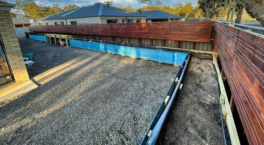

Step 4
Set up H4 treated Pine posts using post stirrups 200 mm from the existing fence (the distance between posts was 2.4 metres). I used a Ryobi 18V Brushless Planting and Digging Tool for the post holes.
Step 5
Connected posts using H3 fence rails.
Step 6
Stained posts and fence rails using Intergrain Merbau stain.
Step 7
Fixed the Merbau timber screening panels using stainless-steel decking screws.
Step 8
Prepared the screening panels for staining by using Intergrain UltraPrep Tannin and Oil Remover and Intergrain UltraPrep Timber Cleaner.
Step 9
Applied three coats of Merbau stain.
Step 10

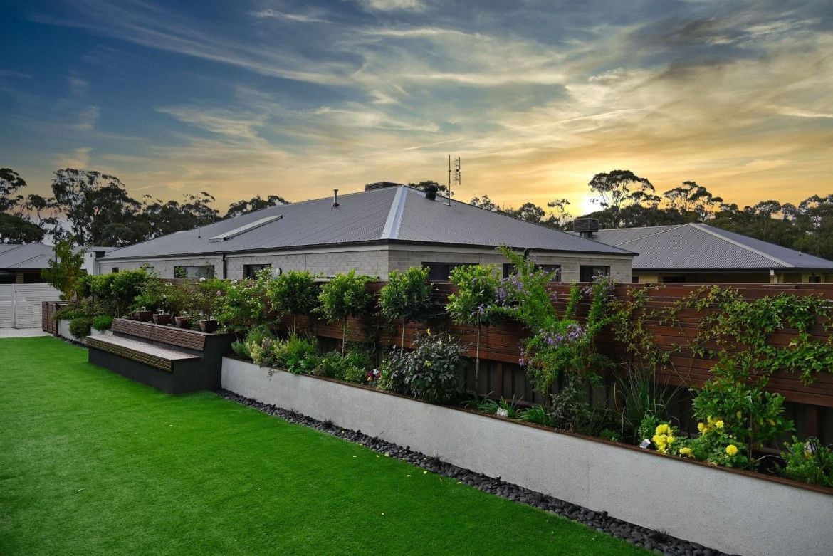

Built raised garden beds using 200 x 50mm H4 sleepers. Used three sleepers to get 600mm height. Covered internal sides of garden bed using heavy-duty builder's plastic. Cemented approximately 800mm sleeper pieces on the front side to support the front walls of the beds. Put internal cross-supports between the front and back walls of the beds to prevent bowing of the sleepers.

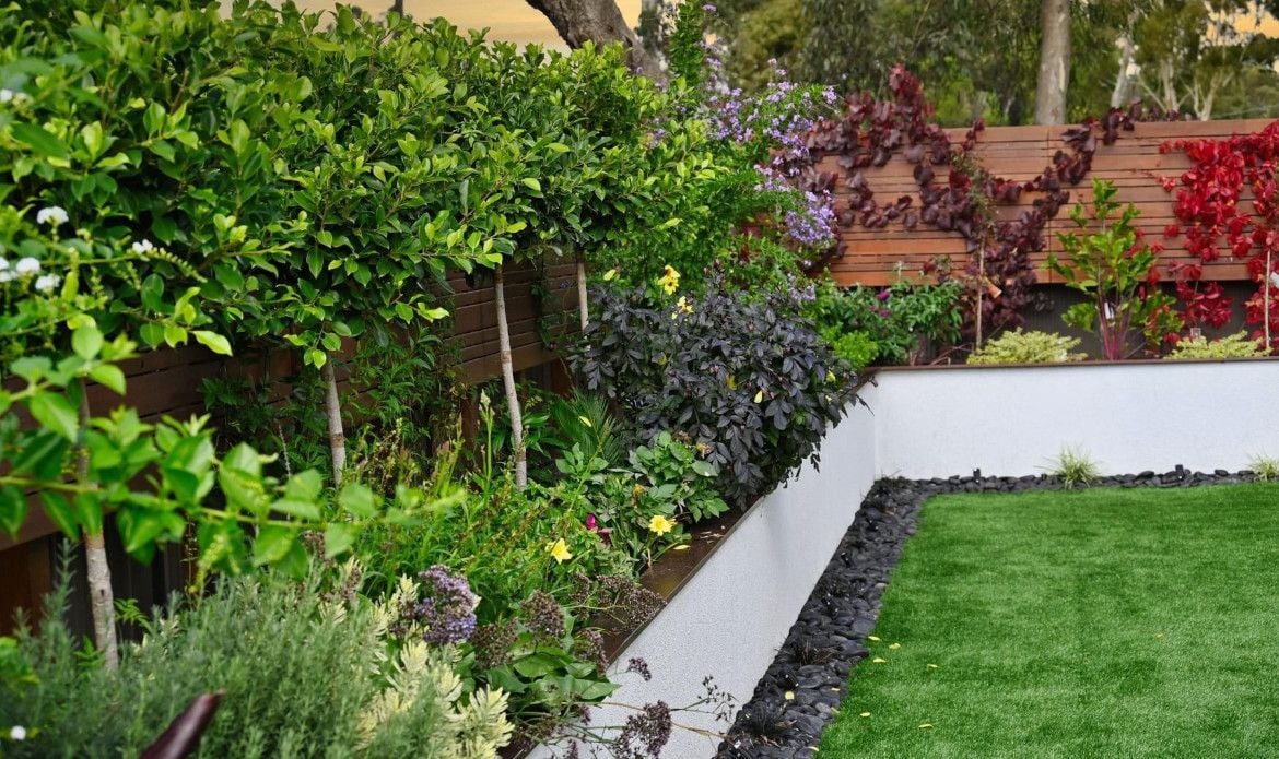

Step 11
Filled the bottom half of the garden beds using the old buffalo turf with roots upside-down to prevent any growth. I covered it with biodegradable weed mat. I filled the rest of the garden bed using garden soil, with a top layer of premium garden soil to give the plants the best possible start.

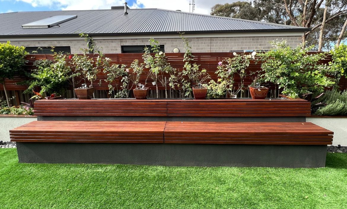

Step 12
Used blue board to cover the front of the garden bed. Used Dulux Texture Full Cover Exterior Paint to get a render finish.

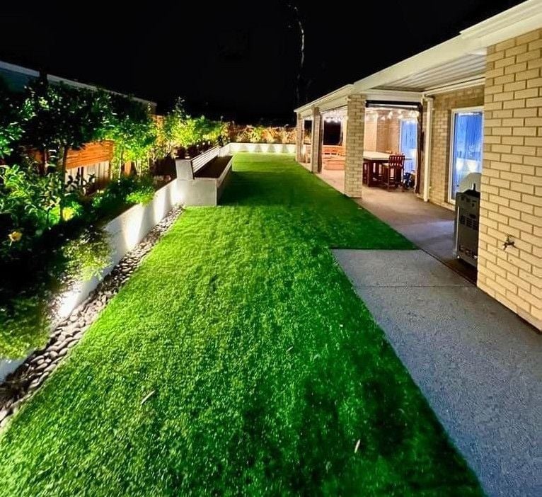

Step 13
Set up irrigation with an Orbit B-Hyve wireless controller.
Step 14
Set up garden lighting using low-voltage outdoor lights.
Step 15
Installed artificial turf per the manufacturer's instructions.

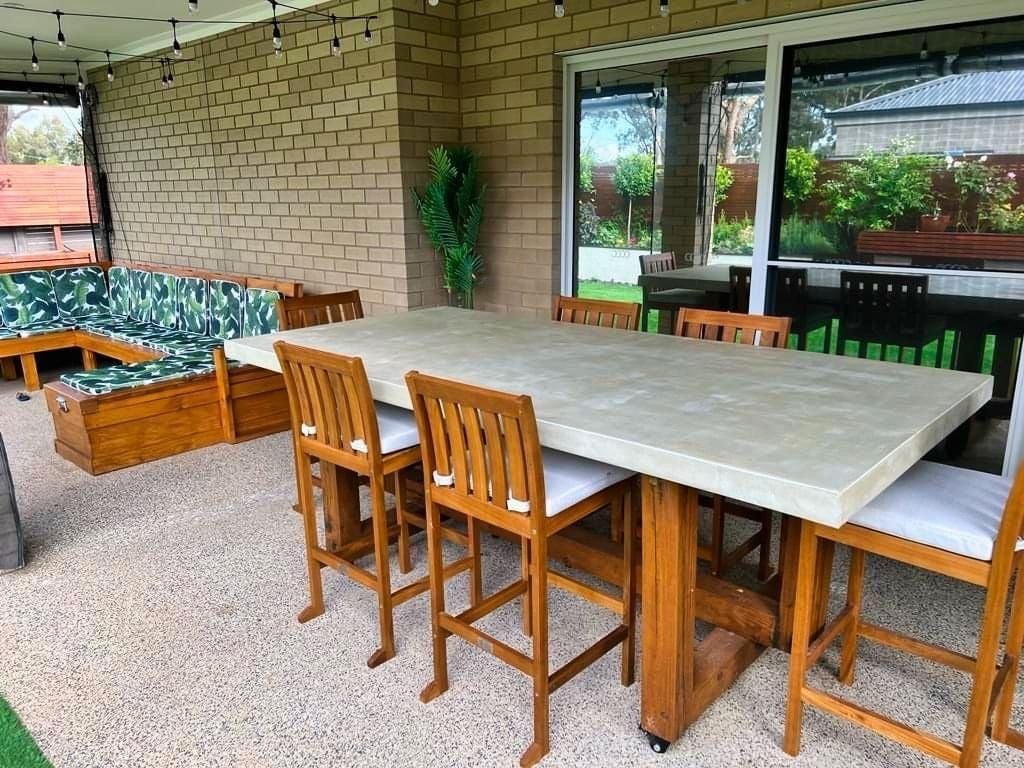

Step 16
Made an outdoor dining table from leftover blue boards. I made the frame made using timber battens with blue boards on top and bottom. I used expanding foam to fill empty spaces to prevent hollow noise. I covered the blue board using fine-coat render to achieve a polished-concrete finish. I also bought Mimosa Malibu bar stools.
