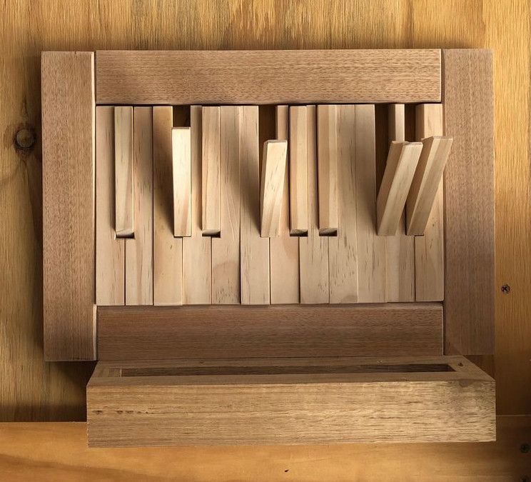

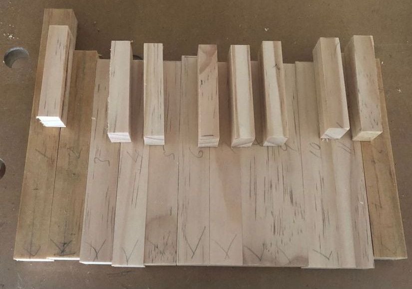

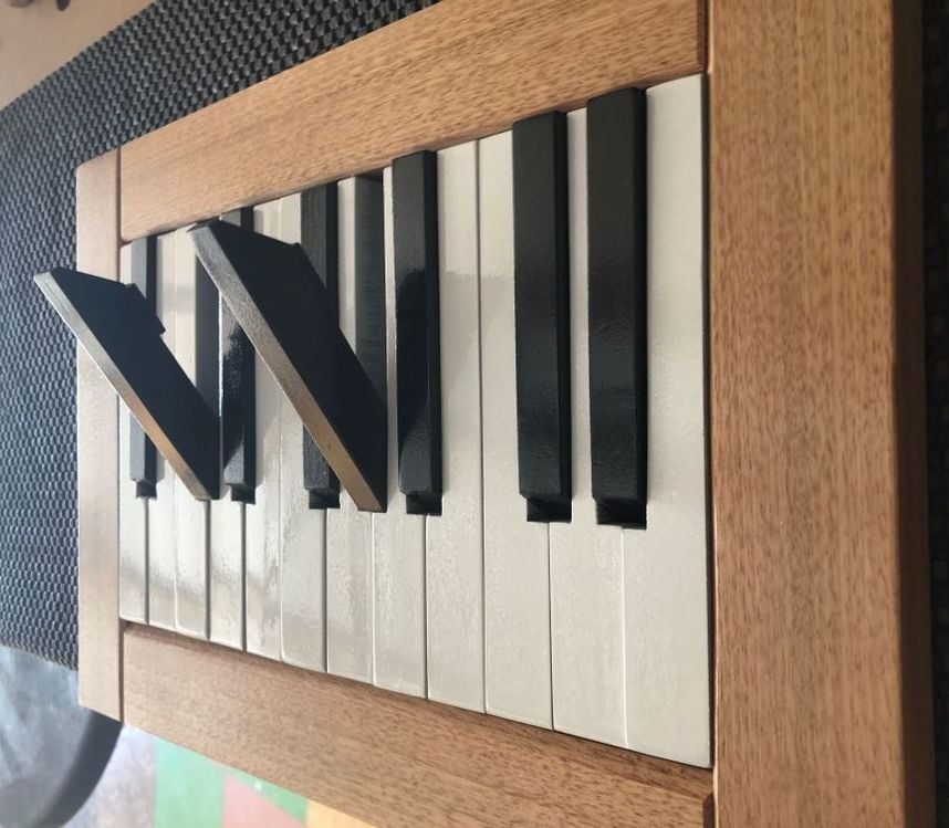

I am renovating my grandson's bedroom. I have painted the room and am just waiting for plantation shutters for the window and a room air conditioner. In the meantime, I have made a coat hook that looks similar to piano keys because he likes music and plays a piano. The coat hook will be mounted to the wall in the bedroom.

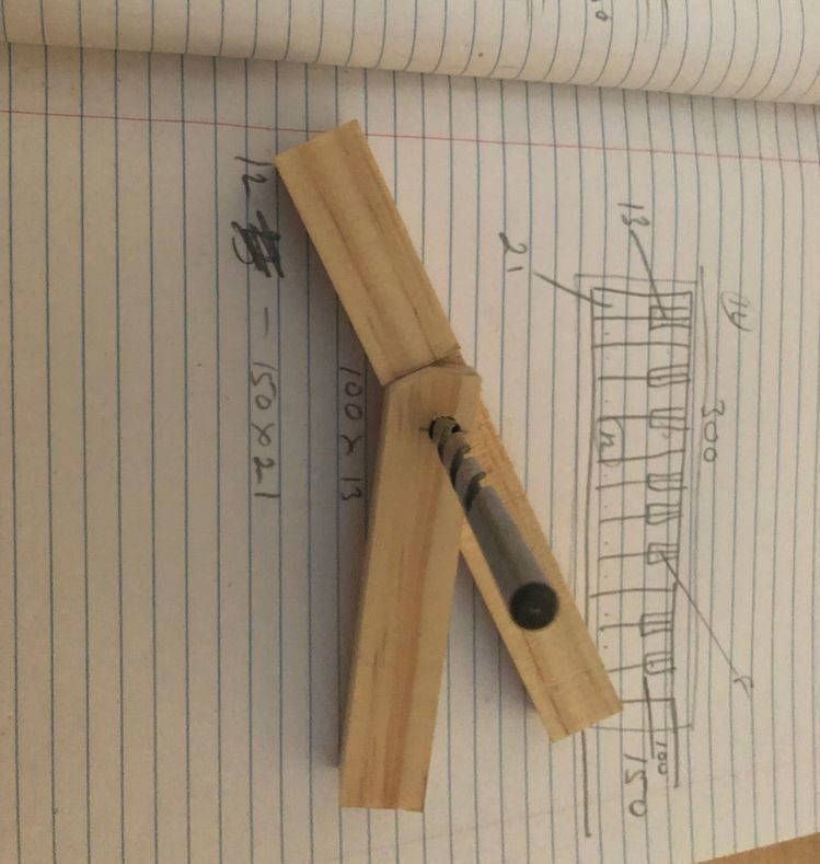

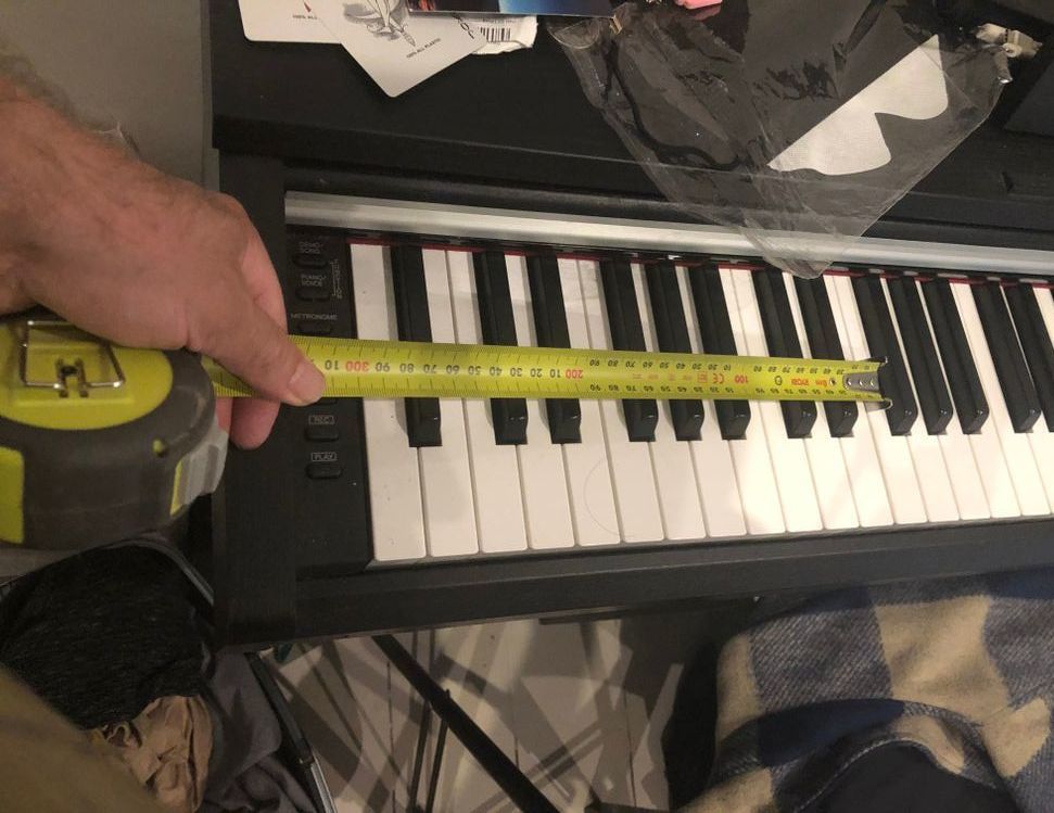

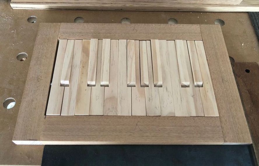

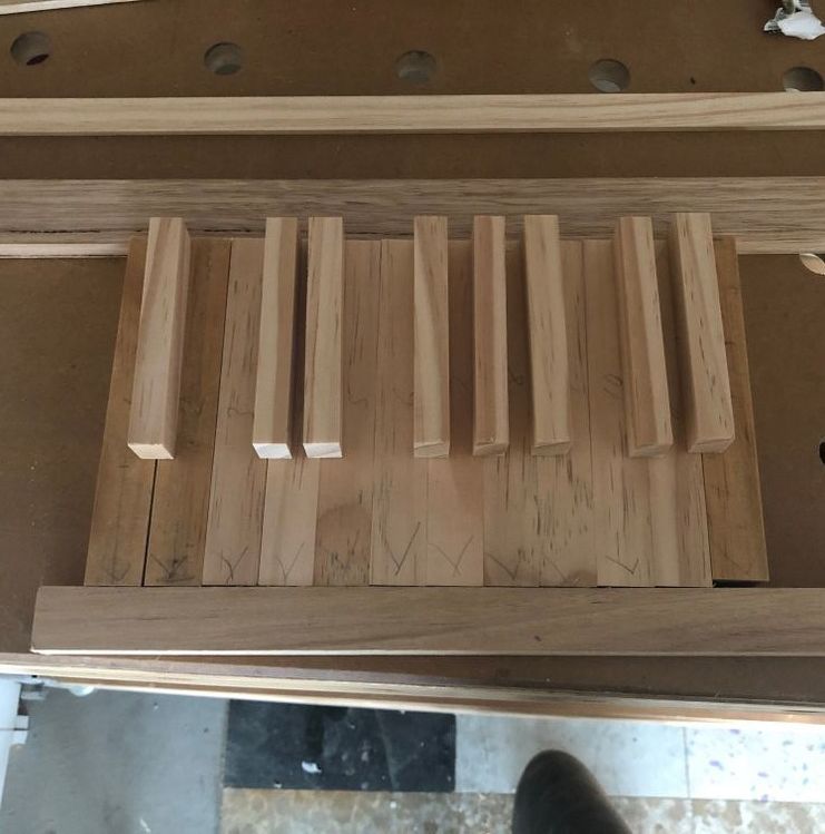

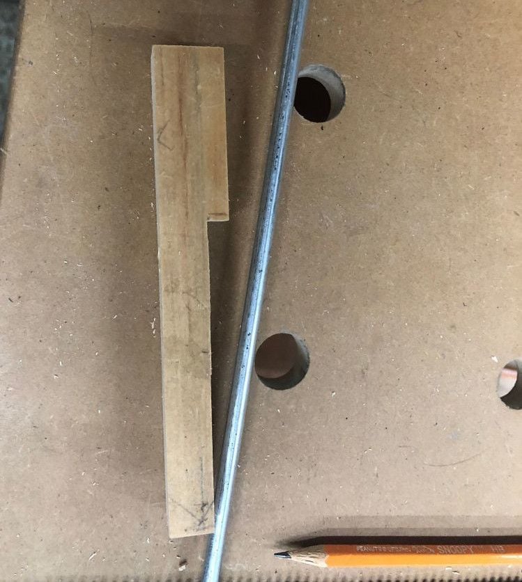

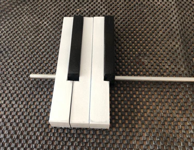

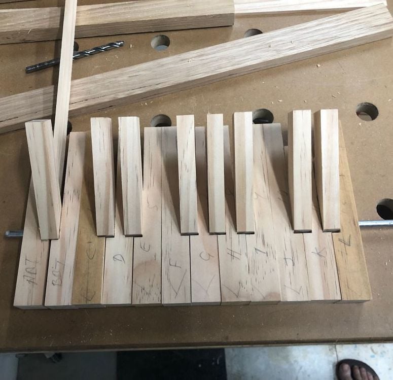

I made them all the same size as real piano keys. I would only hang light clothing on it. I used 19mm DAR Pine for the keys, and 19mm Tasmanian Oak for the frame. I used 6mm rod to assemble the keys together.

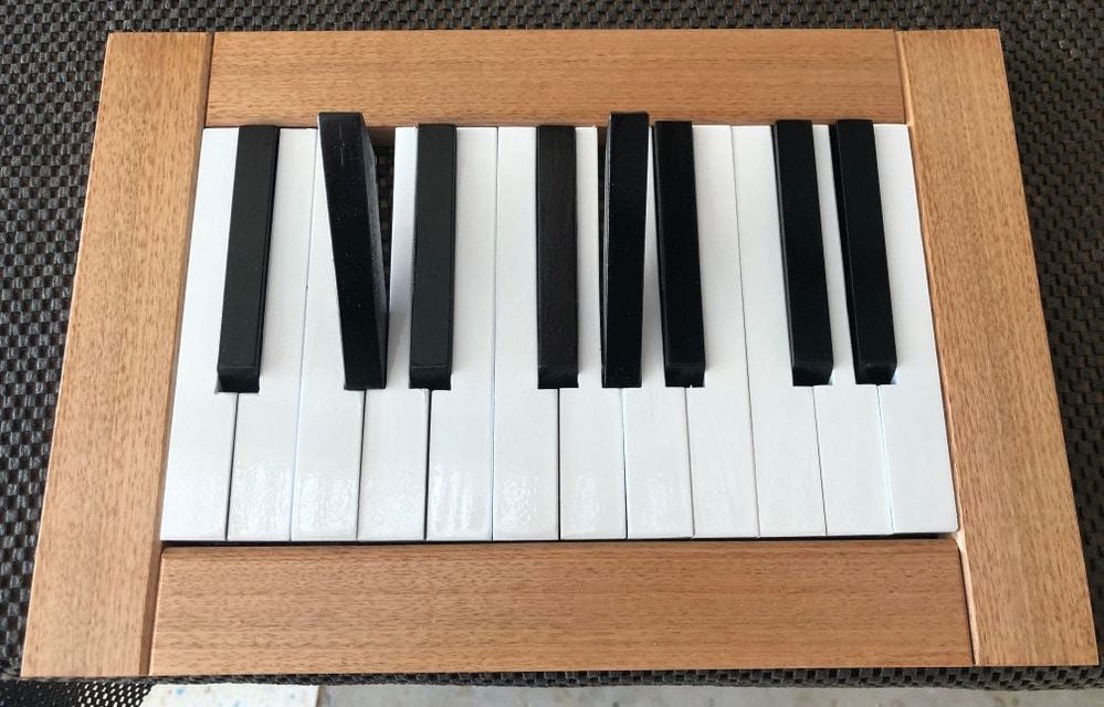

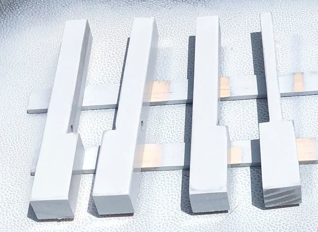

I spray painted the keys individually, before assembly.
