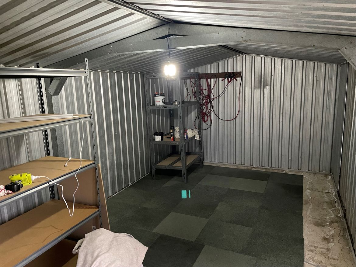

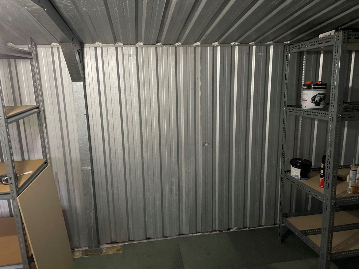

See attached pics of my shed. Would like to put the peg board between the racks. Havent really thought about a design for a frame but was thinking about making a wide frame similar to the bike rack her 🙂
Could you use the racks and build off them? You'd just need to screw a couple of lengths of 90 x 35mm Pine between them to affix the pegboard onto. Alternatively, your idea of creating a free-standing wooden frame would also work well.
