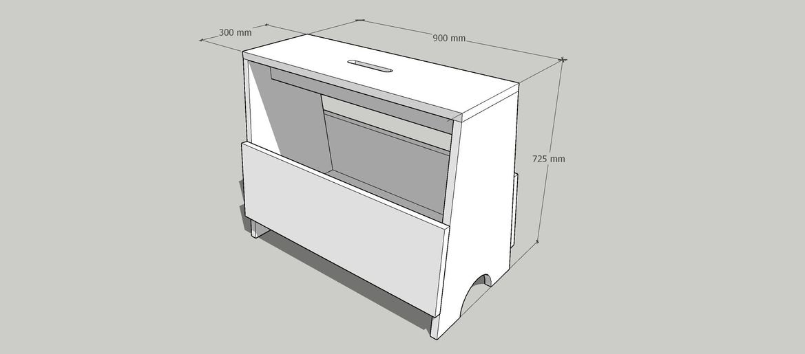

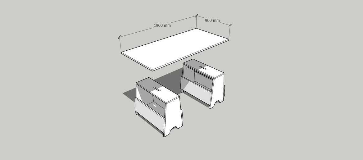

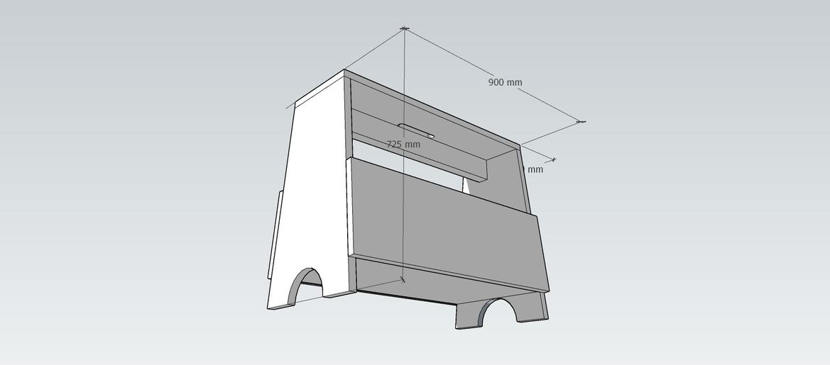

It's fantastic that you've received excellent feedback from our members. Just to add to the suggestions made, I recommend thinking about building your own sawhorse. This would give you an opportunity to practice your D.I.Y skills and build a project that will help you in your workshop.
I've placed a sample sketch below to give you an idea of how you can build one. This is roughly based on my grandfather's sawhorse which doubled as a worktable. He purposed built it to 700mm so that your legs would fit under if you placed a seat next to it. It also served as a toolbox for some of his tools.

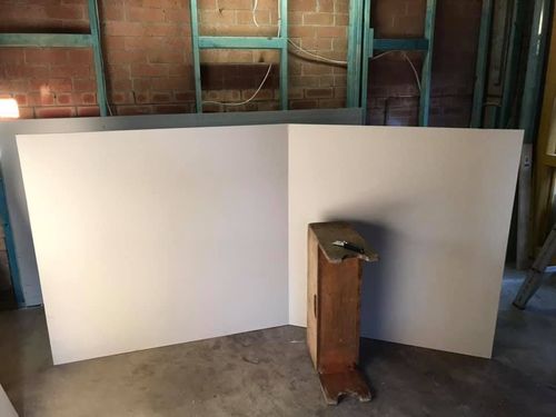

The boxes are the horses, The Pink is a piece of Timber. What I mean by cutting after the last horse is to have the timber cut after the last horse and not cut before. The weight of the saw will flex the timber and make for a rough cut or even jam. If there is a long offcut then the same applies have a horse support the length but cut near the previous horse so there is no flex in the timber. Too many times my brain goes "Its only one easy cut" only to end up with a mess or some sort of issue because I didnt take the time to reposition the horses.
I just saw @EricL @ response and yeah he describes it well.🙂 When starting out sometimes descriptions seem to make no sense. After you start using or even placing tools/build all of a suddern it goes "click" and you go "Thats what it meant!" 🙂 Canmt wait to hear your eureka moment! 🙂

I think I get it now ... but pics would be fantastic! Thanks a million! 😁👏
Brilliant @Dave-1
A picture says a thousand words! Now I definitely know what you mean 👏
