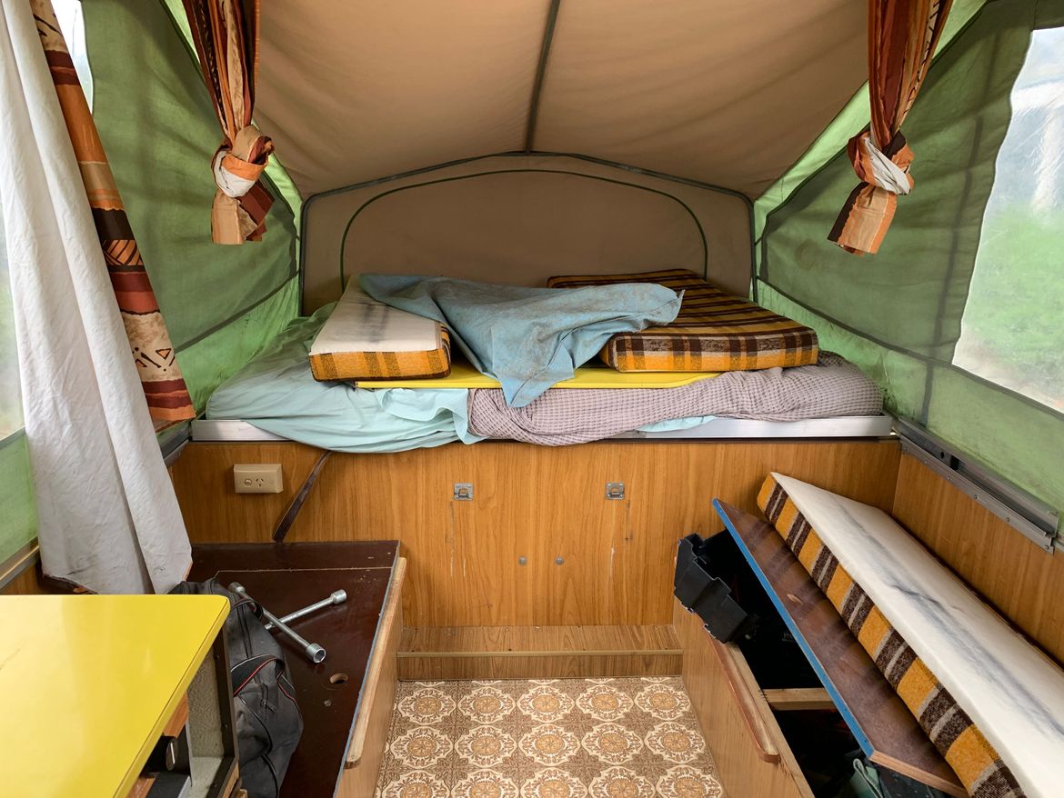

This is how it was before.

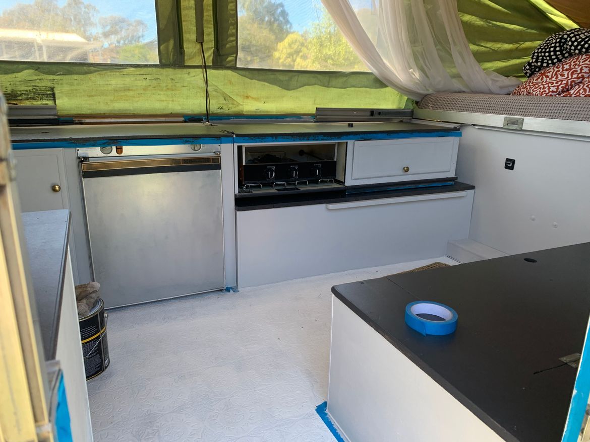

Once the primer was dry, I painted the cupboards with two coats of interior paint and one coat of clear varnish in satin finish for extra protection. It was also at this stage that the fridge didn’t work so I removed it and made additional storage space with off cut ply I had.

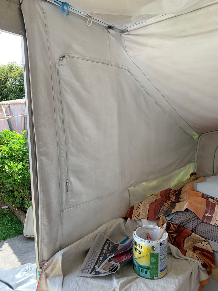

The only thing letting the makeover down was the interior canvas. I watered down exterior paint in white and applied it with this amazing little palm pad painter. Previously, I tried with a paint brush and a roller but this pad was a game changer. It allowed me to have even paint and not too thick. If you use undiluted paint, the canvas will crack when folded away.
I sanded down the surface with 240-grit after it had dried to remove any imperfections in the paint.

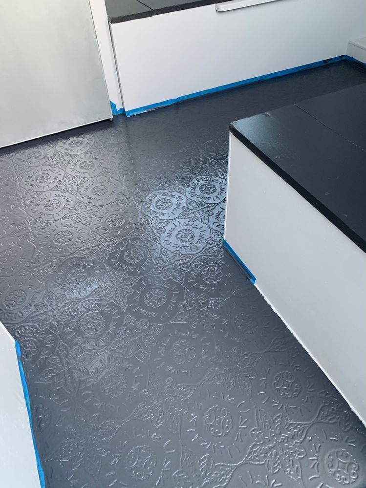

Originally, she wanted to cover the flooring with vinyl planks. I suggested to paint them as the pattern was too beautiful to hide, and I'm glad I did. I painted the flooring and bench tops with tile and laminate paint.

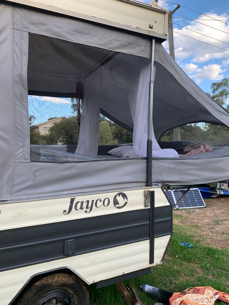

The other issue with the camper was that the flyscreens were broken. My friend had purchased a roll of new flyscreen which I started to sew by hand. This took so much time to complete one screen, so I did some research and saw some people using a soldering iron to fuse the screen on. If you do decide to do this, use a mask as the fumes are toxic.
I did, however, go back and sewed a running stitch after to fuse them as I wasn’t 100% confident that the fusing would be strong enough.
It came up like new. The exterior poles and trailer itself have been sprayed with Dulux Metalshield in Monument and lighter colour in surf mist.

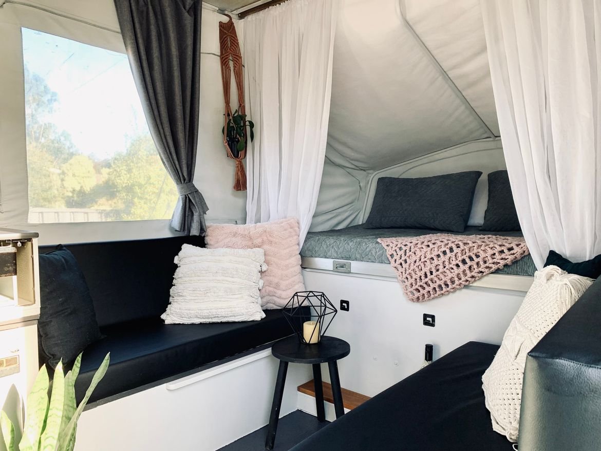

And that is my makeover complete. The camper is now out and about getting dirty and living it’s best new life.
Before and after
