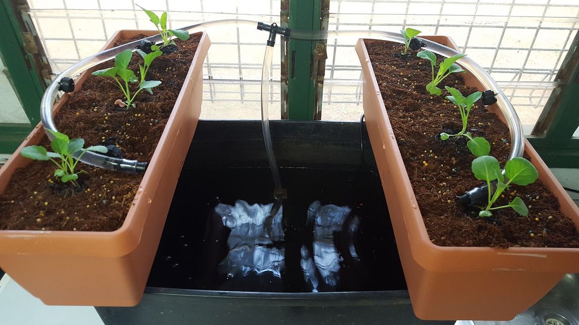

I'm a Cub Scout leader, and this term we're focusing on Our Environment as the term theme.  As part of that, we are examining (amongst many other things) plants.  Last Monday at our weekly Cub meeting, we setup an aquaponics system in the hall to investigate and watch how a simulated eco-system works.
We broke the project into two components, the aquatic section and the plant section. Â Water from the aquatic section must feed the plant section, which must return filtered water back to the aquatic section. Â The aquatic section therefore needs a pump to move water from the tank to the pots. Â And if we elevate the pots above the tank and have holes in the bottoms of the pots, the water will return to the tank. Â And that's our basic system.
- 1 big black tub (fish tank)
- 4 gold fish (and fish food)
- 1 water pump (pond pump really)
- 2 pots (use the ones with the built in side water holes)
- growing media (something course like coir or pellets to filter the water and hold root systems is best)
- plants!
So the Cubs setup the system described above, and here is the system ready to operate.
