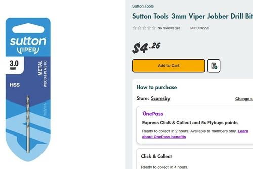

I've had the most success with Sutton HSS titanium tipped drills which have performed the best and lasted the longest of all others I've tried to date and thus would recommend those.
