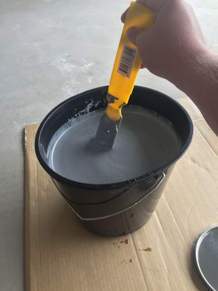

Once the floor was all prepped I began the process of the mixing the contents of the epoxy kit. Due to the temperature on Good Friday (below 15 degrees) I had to mix the activator and the base for slightly longer than the recommended 8 minutes and the resting time was recommended at 25 minutes so I left it for 30 minutes just to stay on the safe side.

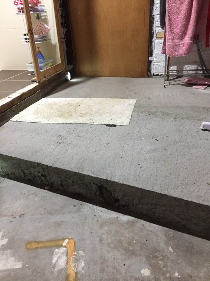

Hi. Is this epoxy self levelling? I have to correct a small amount of error where 3 smaller slabs join. Its for a new ensuite area. I realize I would have to do something about the edges so it doent flow away. Im thinking of timber to hold it in while it dries. I was going to do tiles but I dont want to risk following the wrong curves. Thanks. Regards Marita.

Hi @Marita - I'm unsure if this product specifically is self-levelling. From my experience with the product it was applied exactly like paint so not much levelling required for my space either. That being said the finish has been a perfectly smooth surface despite the crevices between the concrete floor slab.
From a quick google search there do seem to be some epoxy products available for this purpose that are explicitly called out as being self levelling so potentially worth looking into those. Hopefully that helps and good luck with your project!
