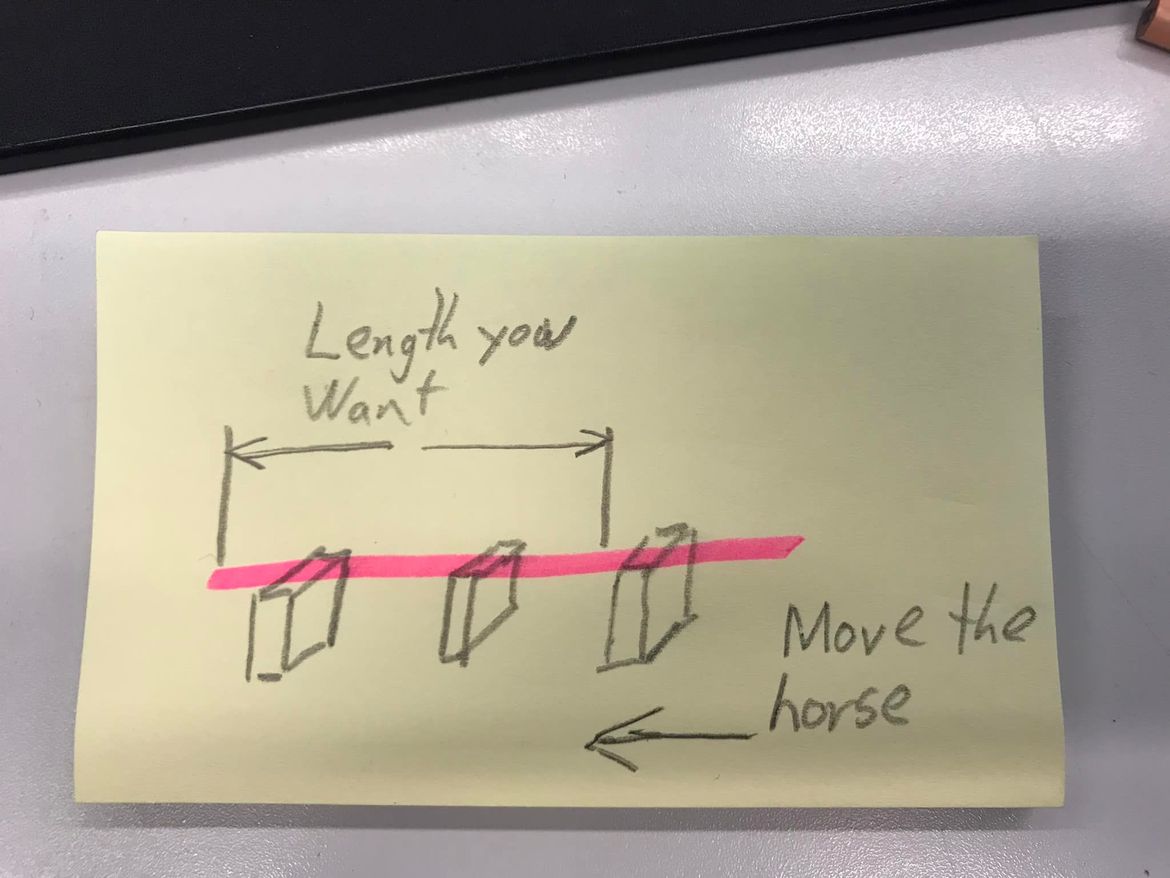

I will try and remember to take some meausurments this weekend. I might even make a table.... But shall see ![]()
The boxes are the horses, The Pink is a piece of Timber. What I mean by cutting after the last horse is to have the timber cut after the last horse and not cut before. The weight of the saw will flex the timber and make for a rough cut or even jam. If there is a long offcut then the same applies have a horse support the length but cut near the previous horse so there is no flex in the timber. Too many times my brain goes "Its only one easy cut" only to end up with a mess or some sort of issue because I didnt take the time to reposition the horses.

Hi @Dave-1
I think I get it now ... but pics would be fantastic! Thanks a million! 😁👏
Brilliant @Dave-1
A picture says a thousand words! Now I definitely know what you mean 👏
... and I feel like nominating you for an Archibald art prize for your drawing! 😂
hahahaha mmmmm a quick scribble on a post-it note and the horses arnt even the same size but was too lazy to redraw ![]()
Thanks tho ![]()
