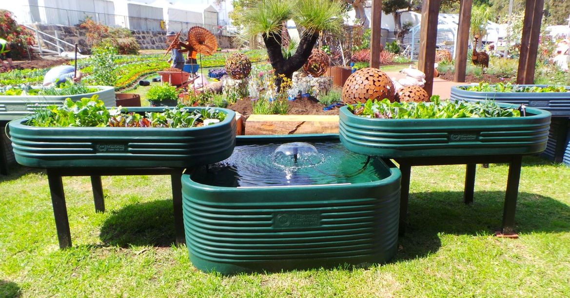

@Jason, it seems kinda expensive at almost $700 for just the 2 trays & the UV pump alone. :think:

Closer than what Bob has to what I can get away with.
Pond
For fish as a prototype I am limited to Shubunkin or Comets.
Koi are baned here and the area is too small anyway for them.
Water lilies in the pond and dwarf Cana Lilies in grow tubs with some swamp plants, larger Canas in pots around the pond.
UV filter saves the asian mum reaction to green water spoiling the view.

240l @Andy_Mann with 2 x 100l filter/growbeds.
I am thinking 5 fish so they can grow to their full 300mm size from a 50mm starting size. 8 + 1 black is the perfect mix according to the experts on harmony,I won't have enough room for that many unless they are kept stunted like in a goldfish bowl.
