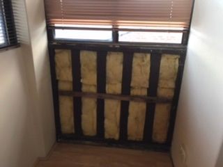

Hi Bunnings expert team
I am going to replace a plasterboard wall, could you tell how can I do it, thank you

Hi @Maymay,
The tool to use is a score and snap knife. Once you have marked the lines you want to be cut you will then place a straight piece of material along the line as a guide. You need to run the knife across the board and along the guide several times to make a groove. You can then snap the board along that line.
There is no service available in-store to cut these boards. You can ask a team member to help you in cutting the board and they might be able to provide some assistance.

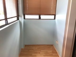

The job was done
Best regards
Maymay
Re: How to replace a plasterboard wall?
Hi @Maymay,
That looks fantastic, you should be very proud of your efforts! Many thanks for updating us with a photo now that you are finished.
