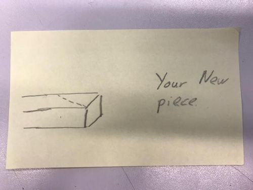

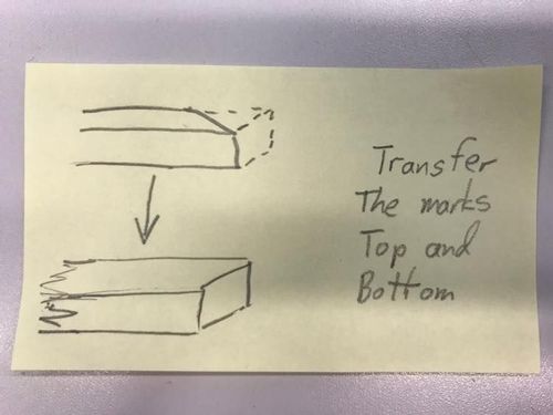

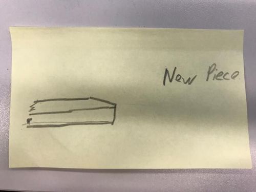

I would buy some pine lengths from bunnings that match the length needed then (after a few practice cuts as @EricL suggested ) Have a go at an angled cut.
-Its treated pine so it wont be super hard to saw.
-If you use the orginal piece to mark out on the new piece you will see what needs to be done. (If you dont have it we can guestimate it)
So on the length of post you purchase, cut the angled piece first, that way if something goes wrong you can try again before getting the overall length with a straight cut.

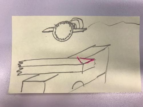

- Once you have marked the new post whith the old post I would suggest to set your circular saw to its max depth cut and do one side
- Flip the timber over and cut the other side. Your cuts should meet up and if you are lucky cut through the whole thing. If not then your hand saw comes into play for the last bit in the middle.
- You can use a hand saw to cut the whole depth if dont want to use a circular saw. Workout and a half if you are not use to sawing but satisfying when done
(also its going to be pine so an easy timber to saw through.)
The highlighted bit in pink is the part you will half cut through and then flip to cut the other side. There is an adjustment depth on the top of the coping of the circular saw if you look around at it. Some kind of butterfly nut which will lower the base plate or raise it depending on how deep you want to cut something.

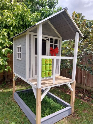

I ended up just using the posts I had to hold the front part of the roof up - less hassle.

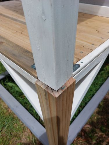

Before I drill them into the roof, I'd like to know what I should use to waterproof the space where upper post joins with the lower post (see photo).
I don't want any water to get in and sit there.
A friend said I could use this in between the posts: https://www.bunnings.com.au/bondall-1l-monocel-in-ground-timber-protector_p0039110
Are there any other methods or products you recommend for waterproofing between the posts, or in general?

Your friend is right you could use that inground timber protection but it could look pretty messy up there plus you may find you cant paint over it. The timber slats for the roof will protect the posts as much as the rest of the cubby house. Id probarly give 3 or 4 coats of exterior paint to the top of the posts to seal it more then use the black protector.
Is the timber slats like a toung and groove? And what are you painting the roof with?
