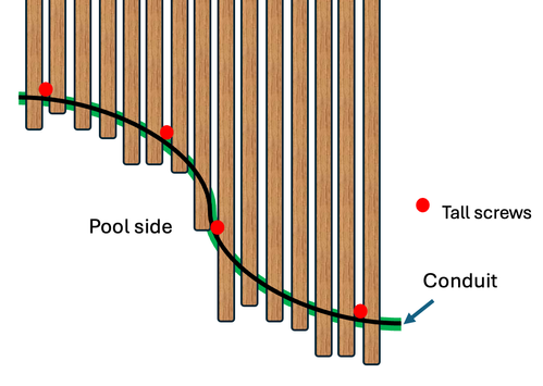

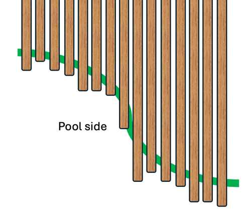

Regarding getting the curve of the deck marked to cut is also a challenge when your trying to follow the coping thats under the boards. You can continue to do one board at a time or lay multiple boards and follow a longer cutting path. To do this, start by driving 100mm screws at curve points leaving them 50mm high off the deck. These will be used as temporary posts to bend 20mm conduit around that follows the coping by simply looking down through the gaps. You may have to move the screws about to get the right line with a combination of screws on the inside and outside of the conduit. The screws would be fixed in to the joists between the boards. Then mark your cut line.

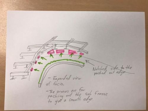

So the post was on Page 7 of this thread just before your photos I give a description on how you could make a bendy piece of facia.
I will attach a pic on the idea, just need to sketch it first
The highlighted green segmants are notches you would create in your facia board, pretty much set your circular saw to half the thickness of the facia board and do a bunch of cuts next to each other. So cut, space of a cut, then cut again. No need to measure, just work your way along the board. Over the area that requires the bend.
This is what I mean by padding out your frames to make it easier to have your facia board bending. The idea is to smooth all the deep parts of a bend so its more "even" and that way less strain on a board.

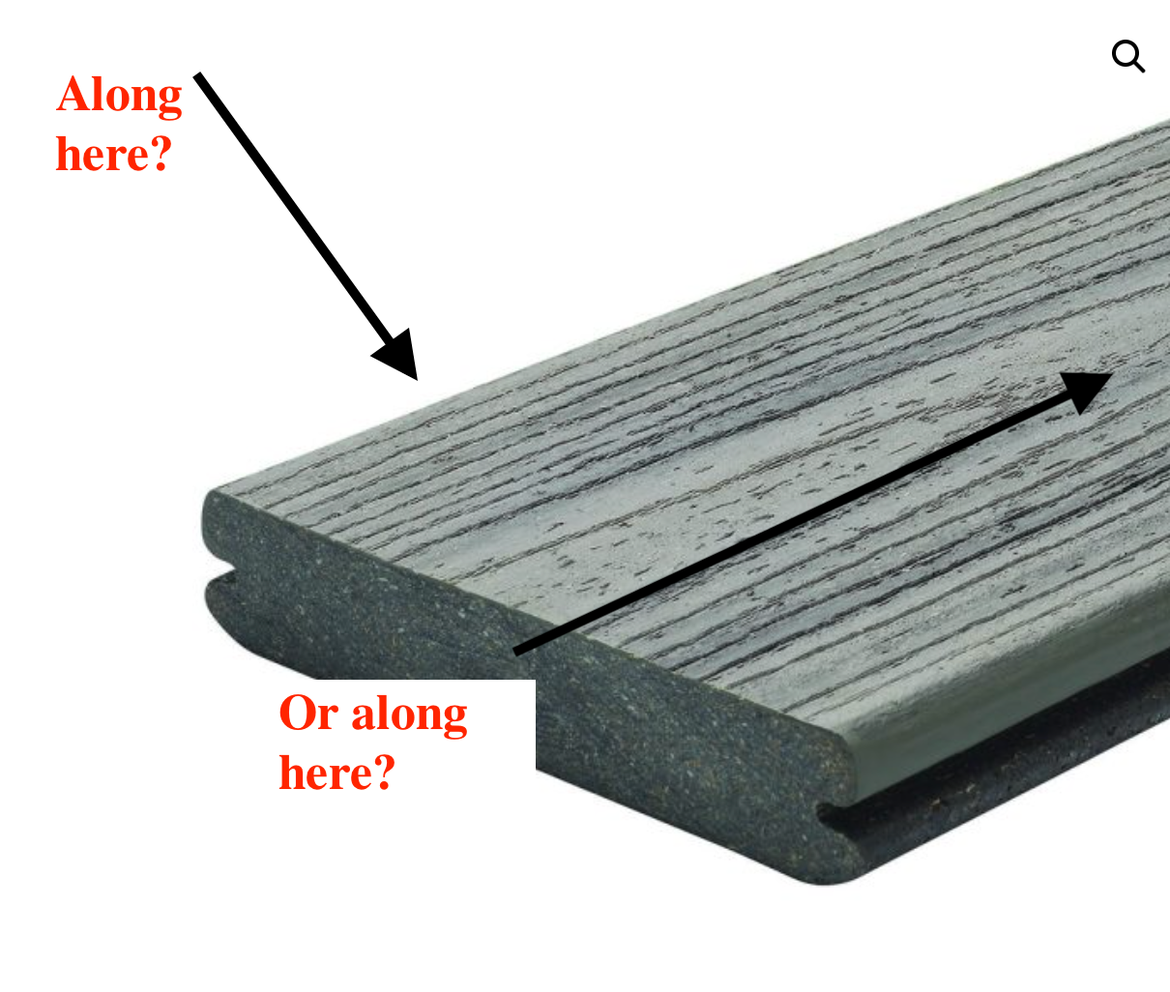

This is awesome Dave, and so detailed. Thank you. The composite decking does seem really tough to bend but I guess with cuts like you say it will buckle in easier. Im not that experienced with the circular saw, I actually borrowed a large one (the kind that isn't so portable as the hand held ones) and I can explore how to do it, so you are saying just cut half way into the deck board and that part you need to bend will go eaiser?

Across the width of the boards. You will have to adjust the height of the blade to the saws foot so it cant cut deeper Dont try to do it by eyesight lol I have done so and ended up with a bunch of smalle pieces.
I have NOT tried to do this on eco board (I am not keen on that material is all) but the theory stands. Its one reason I recommend practicing on it first to see how it goes and see if you are confident on doing it.

"Along here" the top one to be exact
