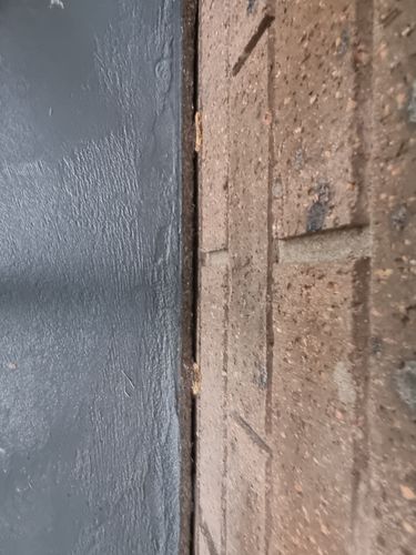

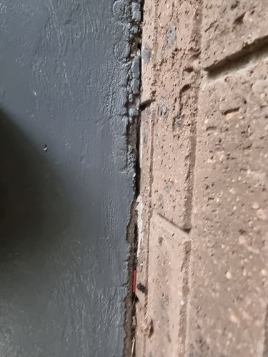

Hi Guys, I have a single storey house where it has a gap between external brick wall to the cement floor of the pergola. I understand from one of the posts it is to accommodate any movement. But I'm bit concerned as I can see in some places the gap is more than 1cm and insects are crawling out of it during night times.
Need a suggestion whether it will create a environment for termites to enter through brick gaps and also want to eliminate the pest activity in this gap space.
Kindly suggest some ideas and solution for this.
Attached photos of some of the gaps

My apologies for the late reply. Looking at the photos you posted it appears that the gap is not too severe. I suggest using Sika 300ml Grey Sikaflex 11FC Plus Polyurethane Adhesive Sealant. For the gaps that are very deep and a bit large I recommend putting in Moroday 15mm x 5m White Gap Filler Rod to prevent the sealant from flowing too deep into the gap.

I took a look at the pics you shared, and it seems the gap isn't too wild. Totally agree with @EricL's suggestion on using the Sika Polyurethane Adhesive Sealant. It's a solid choice. For those deeper gaps, Eric's got a good call with the Moroday White Gap Filler – helps keep the sealant in check. Give that a shot, and hopefully, it puts an end to the insect escapades at night.
