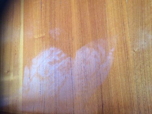

I feel your pain @_Marley_. We had a mat underneath our dogs' water bowl that was damp, when I lifted it I was greeted with this mess... I'm guessing the only fix here is to call back the floor polishing company.
