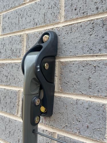

Hi! I’ve just installed the Hills compact folding clothes line on my brick wall and 3 out of 4 of the anchor connections are loose.
When drilling the holes of those loose 3, the drill bit went through the holes inside the brick (10 hole bricks) and when inserting the sleeve anchors (m8 x 70) they couldn’t fully tighten.
Now that I’ve put it all up, those 3 bolts will not fully tighten to the wall and the connection is loose. The fourth bolt missed the holes in the brick and tightened fine.

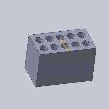

The anchors are m8 x 70 and I’ve uploaded a pic trying to explain where I felt the drill went through inside the brick. It just broke through the second row as I got to my depth marker.

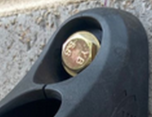

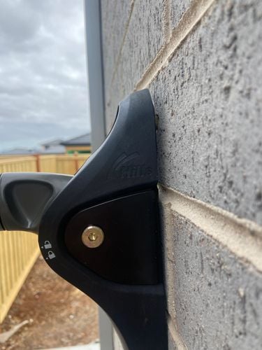

I’ve also added pics of the connections

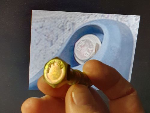

"sleeve anchors (m8 x 70)"
Maybe I'm not appreciating this type of anchoring system, but I thought I should see the bolt ends in your photos? And they're not nuts.
Are you using concrete bolts with washers?

Your Dynabolt is expanding within the cavity and unable to grip into solid material. My recommendation would be to remove the bolts, fill the entire cavity with Ramset 300ml Chemset UltraFix Plus and re-insert the bolts. Tighten them slightly once inserted. Wait for the glue to cure before tightening down the bolts completely. Alternatively, you can switch the bolts out for shorter ones that will grip the rear face of the brick cavity, as per the image below and Ramset's specifications for hollow blockwork.

Hi @MitchellMc
"@Noyade has mentioned Ankascrews,"
I was just trying to ascertain what @Bronski has used. I thought it looked like a concrete bolt or Ankascrew (the correct term?).
I always thought a Dynabolt was an exposed threaded bolt that used a nut to lock down on - so your diagram above is a new product to me.
