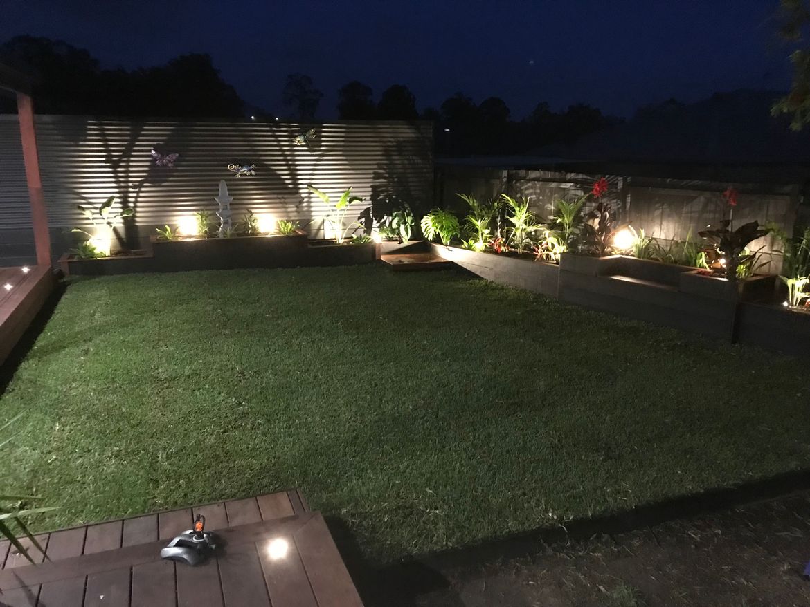

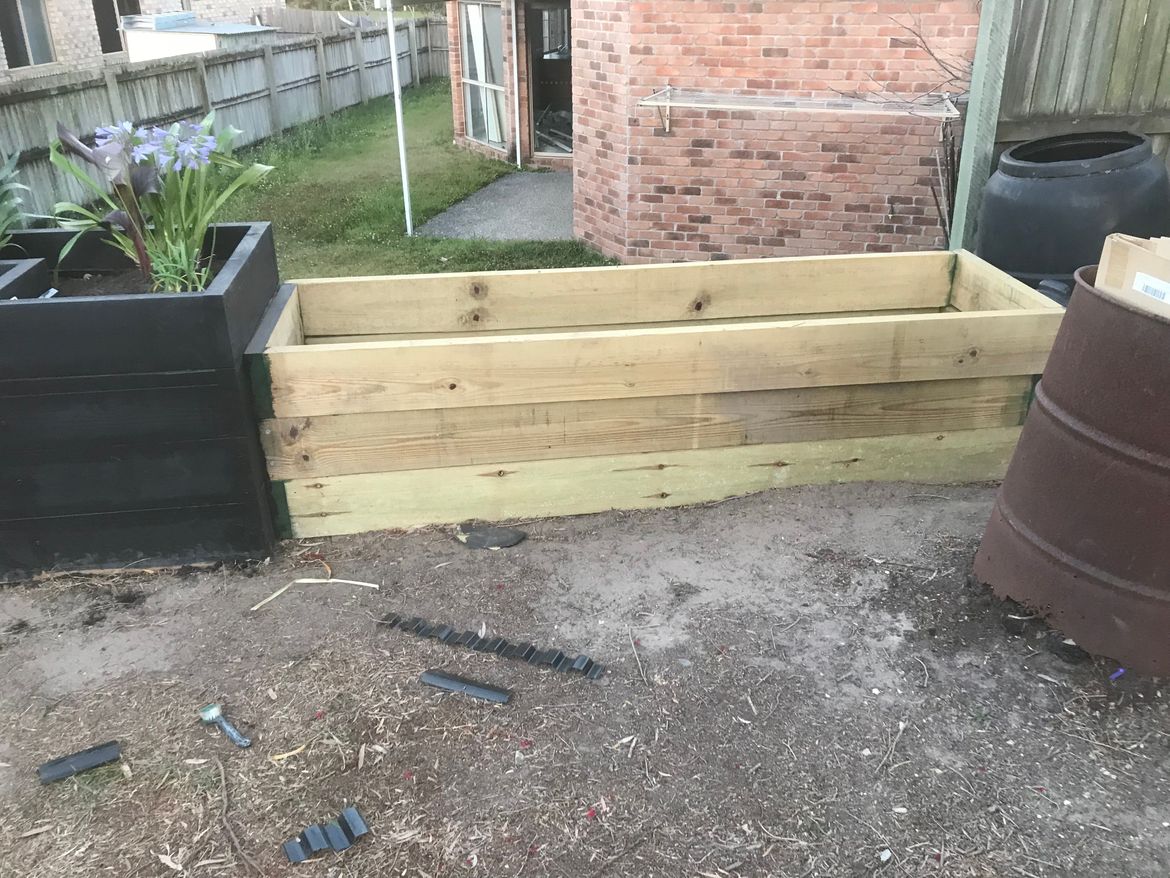

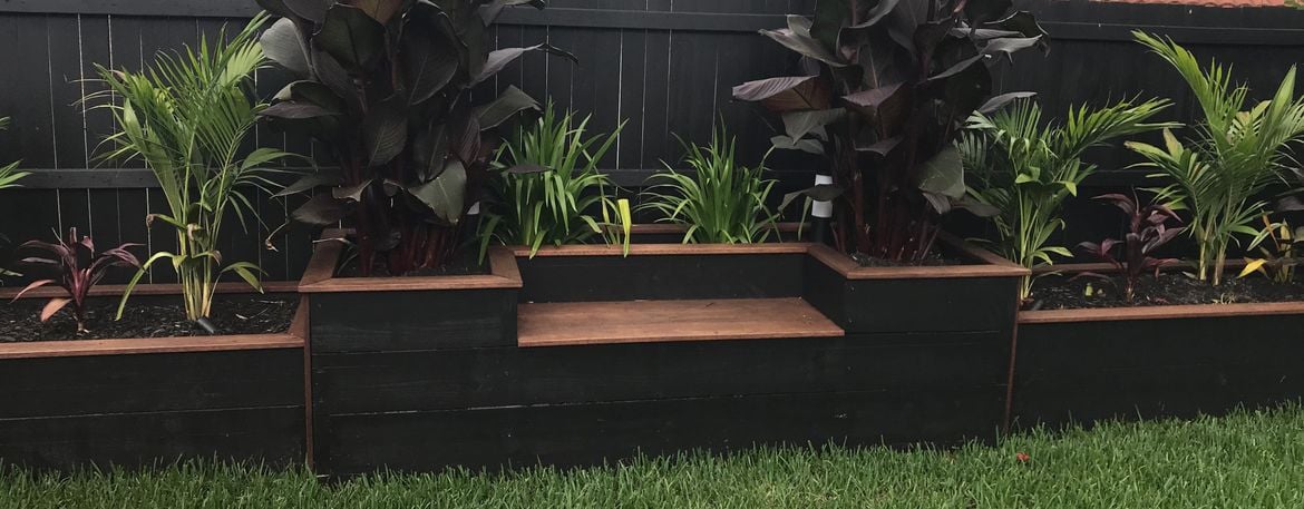

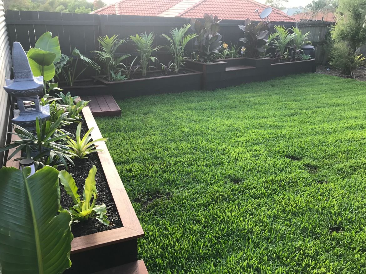

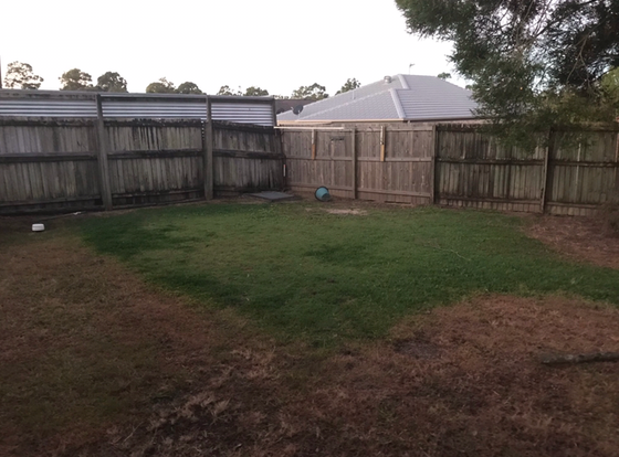

I started with a bare, desolate space and turned it into our little piece of paradise. It took me about six weekends to complete all the planter boxes, juggling kids and other commitments.
I was a bit slow as I have never done anything like this before. All the soil and mulch had to be brought in by buckets as the side access was limited. It took some time!

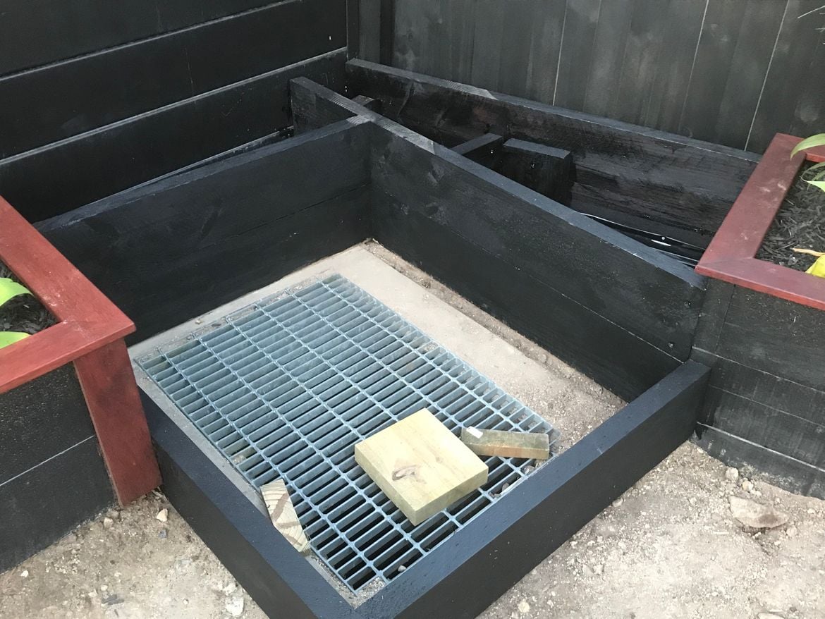

Getting the boxes level caused a few headaches, and getting the angles on the all the cuts was a massive challenge as it was all new to me. It was also a bit scary using a drop saw for the first time.
The knowledge I got from the Bunnings team was so valuable. They must have been sick of the sight of me!
The soil goes all the way to the ground. To keep the weeds away I put a layer of cardboard at the bottom.
I also used some polycarbonate roof sheets to line the sides of the boxes to to keep the soil from contacting the wood and prolong the life of the boxes. I only used these as I had them left over from the old roof I took down. I also painted the wood.

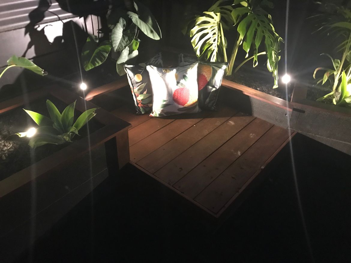

On the seating area I used MicroPro-treated sienna Pine as there were going to young kids sitting here eating at times.
