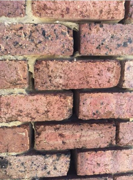

Here is an email I recieved

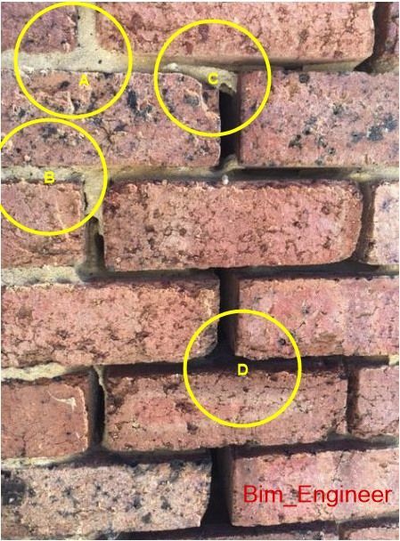

"Thanks for the photo.. I'll put it to good use"
Could possibly be caused by bad mix, Aerating additive added to lime based mortar mixes ,etc
Stages
A. Air bubbles in mortar weakening strength and durability
B. Air voids enlarge
C. Chunks of mortar errode and fall out
D. Eventually wall becomes unstable
 Repointing should be carried out at C well before D
