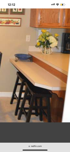

What would you call this and where would I find one to install again? We have barstools at the end of counter now and just not very functional. PS — home has been majorly remodeled
Welcome to the Bunnings Workshop community @lauraleigh710. It's a pleasure to have you join us, and many thanks for your question about benchtop elements.
Any protrusion from a countertop such as this is typically called a breakfast bar. They can consist of the kitchen bench extending out a certain distance to accommodate, or as in your picture, they could be a separate supported element.
It sounds like your kitchen benchtop is already installed, so you'd be looking for a supported extension. Did you want this to match your benchtop? If so, and if it were one of ours, we could enquire with our supplier about customising a new smaller bench to match and suit your needs.
Alternatively, you could look at installing a timber panel and supporting it with brackets.
You might like to post a few images of the area where you'd like to install it, as they would give our members a better idea of a solution that would work. Let me know if you need a hand uploading the pictures.
