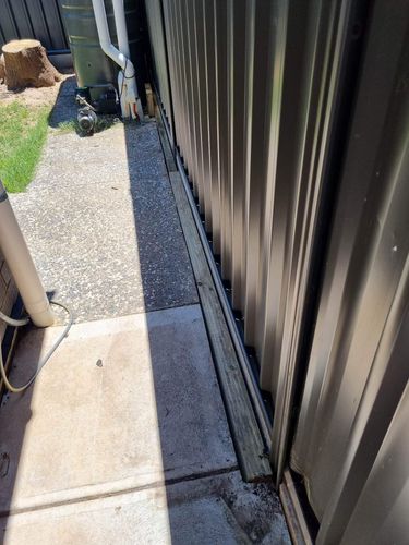

Recently my neighbour removed their back shed which made up part of my fence so they had a new colourbond fence put in. It now has a gap of around 60mm between my fence and my back path and it tapers. There level is quite a bit lower (approx. 500-600mm) on the other side if I put anything down there it could wash away in the rain… any ideas on how best to fill it?
Hi @Snels44
Typically with color bond fences treated pine sleeps slot inside the grooves of the insides of the color bond posts 600 mm sounds like a lot of height and really needs a retaining wall possibly. But 3x 200mm x 50mm x. 2400mm sleepers per fence section will work too.
So look at your colorbond fence posts under the fence bottom see the u shaped hollow there. Thats where the timber slots into at each end normally these are put in before the top part is assembled as they need to fall into place down the full channel length.
So that opens a can of worms for you how do you slot those timbers into place and will you neibour share those costs.? How will you partly dismantle fence to install them?
Plan B using lengths of villaboard a cement like board /sheet like product you maybe able to dig on your fence side and put a sheet of this in on your side and then re piling dirt against it. No need to a fix to fence as ground wieght will hold it in place but I might use metal screws to tack vilawood to the bottom rail to hold it level and neat. Measure your post spacings your villaboard needs to over lap posts for nest results. Cut this in half for 600mm or 500mm what ever you need. 2700mm lengths avaliable too.
Use a villawood knife score and snap to cut villaboard

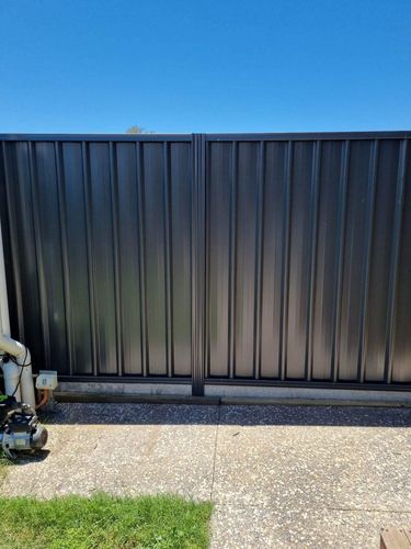

All fixed thanks heaps for your help
Great job @Snels44 looks very neat and tidy. Thanks for post job photo it is the perfect way to use color bond post channels.
You would never know theres drop off on the other side. ![]()
I agree with @Jewelleryrescue - you've done a terrific job of filling that gap, @Snels44. Many thanks for coming back to provide an update and sharing those photos.
