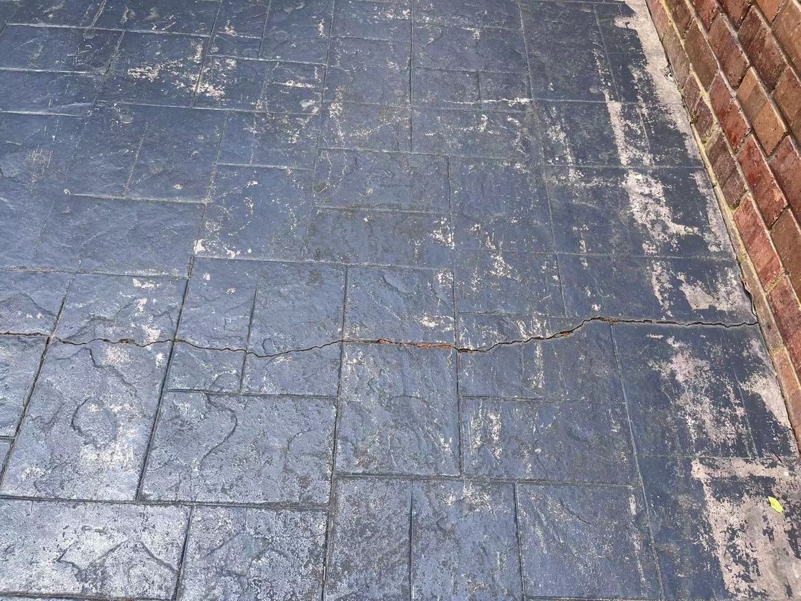

My driveway has a few long and big cracks and somearea's paint has been fading. Can you teach me the step by step how to resurface the driveway and what products I need to buy?
Kind regards,
Shan

I suggest using Gripset Betta 1L Concrete Crack Filler to fill in the cracks of your driveway. However, if the cracks are too deep, I recommend using a Moroday 15mm x 5m White Gap Filler Rod to prevent the filler from sinking too deep into the crack. Before you apply the filler please note that the driveway must be thoroughly cleaned especially between the cracked area of the driveway.
Here is a handy step-by-step guide: How to paint a concrete driveway
I recommend having a look at the White Knight 1L White Heavy Duty Ultra Pave Concrete And Paving Paint. It resists hot tyre pick-up and can be applied over oil and water-based topcoats. It can be tinted to many colours so please choose carefully.
