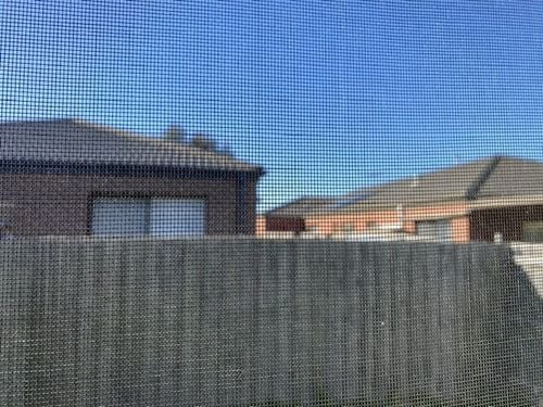

I want to block from the neighbour’s bamboo fence but to the left hand corner and then along some more
the back neighbour has put this bamboo screen thing up on his side as he has got a raised deck along the fence which makes it easier for him to see in to us on either side of it…I want to block to the end of our fence line
I want to block the corner bit on the right, and also along the LH side to where the cat is

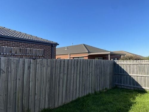

Hi @JacobZ that would help with some of it, problem is they can go up onto the slope, and they can look directly over into my yard, as you can see in the 2nd picture, I've had my dug out and put a retaining wall with a pool, so there is absolutely no privacy unfortunately
