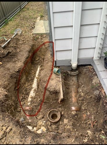

I have an old pipe that is not connected anywhere which is next to storm water pipe that runs towards road.
The issue is when it rains, water comes out of this unconnected pipe and ground gets very damp in that area.
recently I dug that area and got plumber. Plumber put a cap to the pipe and asked me to monitor if water still gets out of pipe when it rains.
i see it still slowly fills up the area meaning water is also coming around that pipe.
This unconnected pipe is under driveway which is concrete and solid. No gravel around pipe. So, I suspect the damage to pipe is very near to the opening.

All the water from end connection is getting into clay pipe.
I hosed down from the other side, and I see water flowing through the clay pipe.
I don’t see any leak from plastic wrapped pipe.
I also put the hose into the opening in clay pipe. I could run the hose nearly 3 metres on both sides into the pipe.
when I turned on the water, it just flows through clay pipe.
Also I noticed that plastic wrapped pipe is not hard one like PVC. looks like it is soft like an agi pipe. But not sure.
that little pool of water you see in photo is because of rain. I covered the dug area with tarpaulin but somehow rain water seeped through.

Mmmm maybe a little more gentle excavation is needed. Trying to figure out where pipes are going is problematic as we wernt the ones who "used common sense" and installed the pipes lol
The description you give does make me think of old drainage pipe next to foundations but no way could you be sure until you find where it connects up to. A plumber and a camera would help in finding what pipes are what. Do any of the three pipes in your photo join up together?
Hi @approachmhn That wrapped pipe if its black or white with slots in it, then is an ag pipe.
That capped pipe that was leaking water when it rains is definitely connected to either an agri system or storm water. If agri, it will be from. your property somewhere. If it's stormwater, it's possibly from either your property or even someone else's. I wouldn't have thought so myself, but a mate of mine has storm water outlets from neighbouring properties within his. And apparently decades ago this was common as ridiculous as it seams.
As @Dave-1 mentioned you might have to Dig up more ground, but to be honest this could go on forever. So I would go with his suggestion to get your plumber or one that has a camera to investigate.

Hi @Dave-1 ,
plumber was here today. He did camera inspection on my property as well as neighbours.
Neighbour’s old terracotta pipe is blocked towards the kerbside and broken at some places.
plumber told neighbours water might be just soaking into the ground and I might be catching that water. Cant say definitely.
He gave me 4 options:
1) Block the clay pipe and simply leave it. Water getting into pipe might just get soaked into ground and issue might resolve.
2) Remove all clay pipes from the ground. Block the end of clay pipe that goes under deck.
Dig a pit and pump water by connecting to storm water down pipe next to it.
3) Take out deck panels, dig under the deck and connect a pvc pipe. where ever he gets certain angle, connect it to existing storm water pipe.
4) put a new agi drain till the kerb side.
he said option 3&4 are expensive compared to 1 & 2.
Not sure which ones to go with.
any suggestions please?
