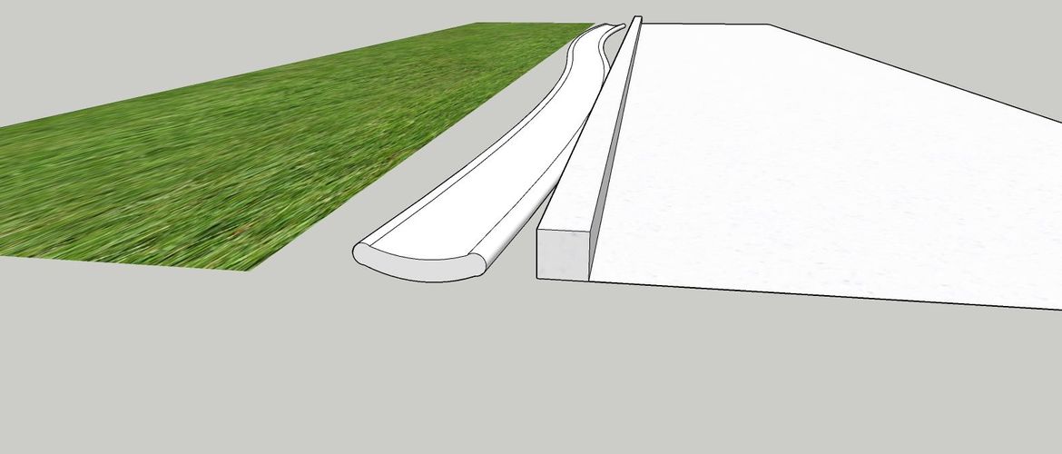

Welcome to Bunnings Workshop! I am a firm believer of DIY channel drains. I strongly believe in working with nature and not against it. So my solution for you is a two step approach. First I suggest creating a shallow U shaped water drain. It's also know as a spoon drain.
- Prepare your proposed area of the channel by creating a shallow channel about 30mm deep and then flattening it out with available garden tools. Use a level to make sure that the fall of the earth points out towards your nearest garden.
- Once you've prepared the ground you can use Bastion builders mix to prepare a cement channel about 150mm wide and at least 20mm to 30mm thick.
- Use a 2 liter bottle of coke or similar shaped bottle fill with water to prevent crushing the bottle, push down in to the wet cement channel to create the shallow U shape. Finish and feather to desired shape.
- While waiting for your cement to dry, visit your local Bunnings and buy some buffalo turf to cover the bottom area of your slope. It does not need to cover the entire slope just half a meter past the body of your diy spoon drain.
What is the turf for? The buffalo grass serves as a natural water buffer before it hits the spoon drain. The grass traps the water and the debris acting like a natural filter. Buffalo grass is very tough and hardy even in the shade so in essence if the grass survives then it should soak up incidental water. But should you get big rain then the spoon channel will redirect it to the garden. A winner in both situations, please note that in the drawing I've drawn the drain as a curve that is to just illustrate that you can build it with the turn and contour of the earth and does not need to be straight. Just remember that the edge of the drain must be level with the earth otherwise the water will just go past it and under the drain. I hope the drawing makes sense and helps you out.
Cheers,
Red

Thanks Red, that's really helpful - if I can't get grass to grow and act as a natural filter, what else would you suggest? Some rock/gravel encased in chickenwire? Cheers, Jim

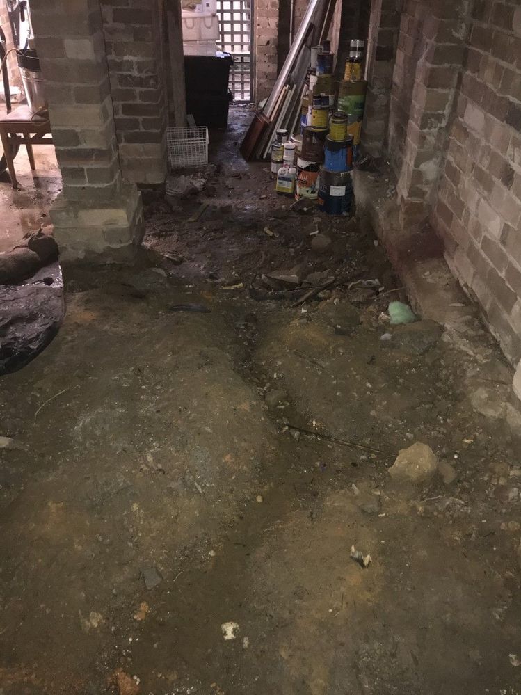

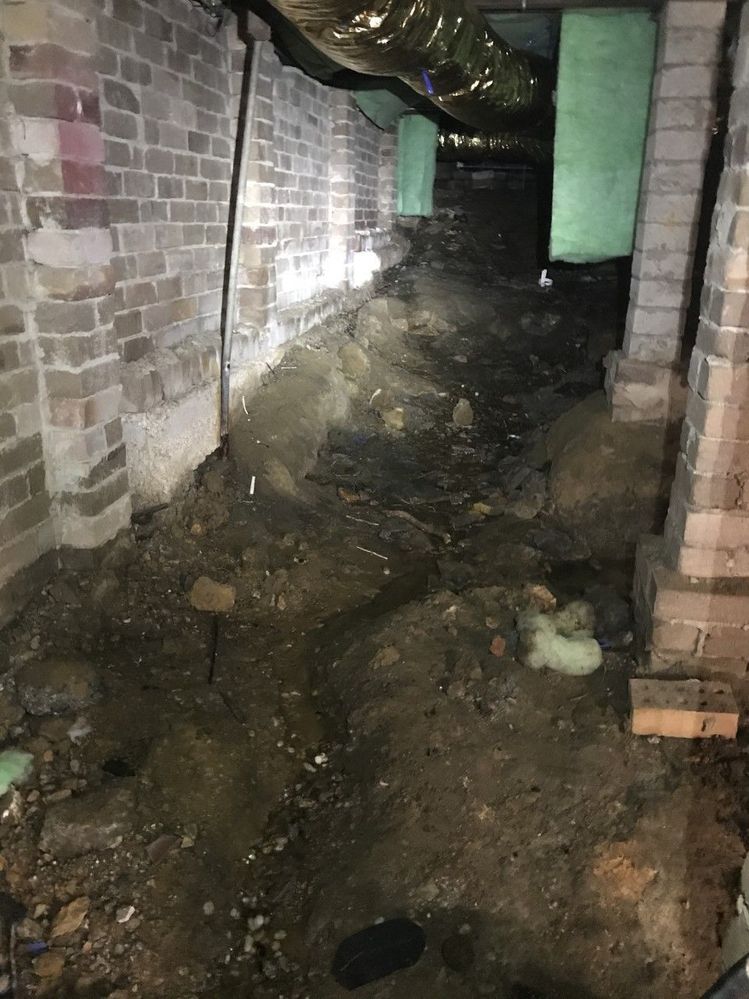

Thanks, Mitchell - that everhard drain / slotted draincoil sounds like a solid approach: would I need to put a sock over the draincoil, or anything like that? See some pics below. Piers have been recently re-done, and there's now drainage on ground level on the high side of the house, but am anticipating a good deal of subsurface water will still pop out halfway down as it emerges from some rock beds along the slope.
Cheers,
Jim

Hi @jbs1,
It's great to hear that you installed drainage on the ground level, and I feel this will really alleviate a good portion of the water flow. If you were to install the drain channel across the slope, the drain coil would remove the water from the channel to distribute elsewhere. I seem to have linked to the slotted version of the drain coil, which is not needed as you'll be using it to transfer the water instead of collect it. Instead, Vinidex 50mm x 20m Black Unslotted Draincoil would be more suitable, and no sock is needed. Alternatively, you could dig a trench 100m wide and 30mm deep around the perimeter of the concrete slab. Drop Vinidex 100mm x 20m Socked Slotted Draincoil into the bottom and backfill with Ki-Carma 20kg 10-20mm Drainage Gravel. The pipe would be run out from under the house and ideally to a stormwater collection pit.
