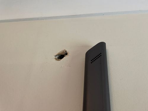

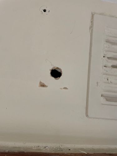

5cm *6cm5cm *6cm4cm4cm
 HI - just tacking on to this post-  I have seen a few videos and seen the other post on this from someone else. The two holes are on your borderline I think -the bigger one is 5 *6cm and the smaller one is 4cm. I want to do this without taking the fans down or cutting up bits of wood. Would the patch kit work here on the big one? What about the smaller ones next to the fan?  Could I just use filler in those ? Could you also recommend the best filler for the jobs?    I am DIY challenged.  The fan installers just assumed I would have someone to do this for me. I don't

Hi @RosemaryK,
Unfortunately, I would say both of these holes need a patch or backing. The smaller hole is on the borderline, but because of the proximity to the fan and the vibrations it will likely experience, it is likely to crack if it is not supported by a patch or backing.
I'd suggest using a Builders Edge 100 x 100mm Plasterboard Wall Patch for both of these holes.
You can cut one down, so it fits around the fan using a good pair of scissors.
Once in place, you can use a plaster filler, like this Gyprock CSR 2.25kg Less Mess Multi-Purpose Joint Compound, to coat the patch. Use a joint knife or plastic scraper to apply the plaster, ensuring you give it a good mix before applying to ensure it is nice and smooth.
Do your best to apply it fairly neatly, then allow it to dry. Once dry, use a sanding sponge to sand and smooth the plaster filler, then brush it down, prime it and paint.
Nothing about this repair is particularly difficult if you take your time.
Let me know if you have any further questions or require further support.
