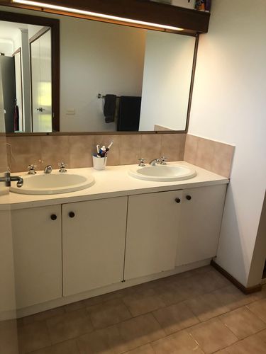

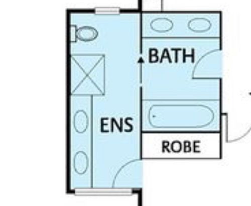

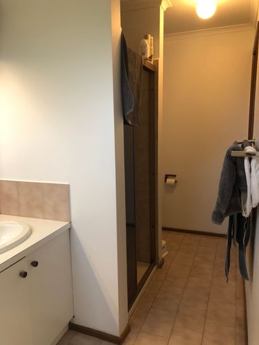

Hi, we’re about to start the planning for our first bathroom renovation. We’ve got two young children so hoping to split the bathroom into two separate spaces. Natural lighting is very limited so we think we will add a wall between the current toilet and the shower, leaving the sliding door to room with the bath for the family bathroom. The other bathroom will Become a proper en-suite and have a toilet added. In all the examples I’ve seen the toilet seems to always to be next to the shower, is there a reason? Could the layout be toilet, Vanity, shower? Would love any tips or advice!

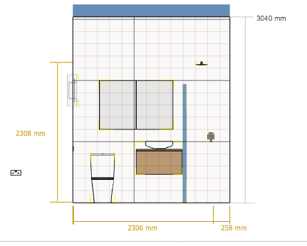

Here’s the floor plan with measurements. I’m working on doing a mock up now. Thanks!

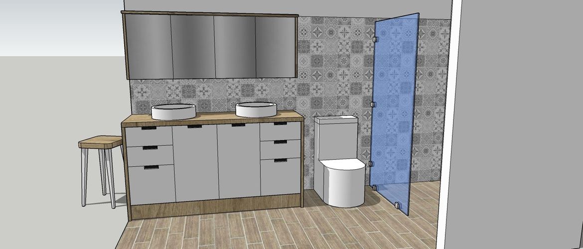

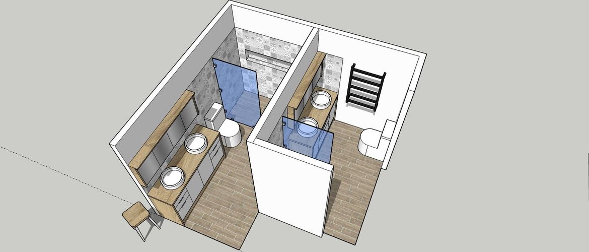

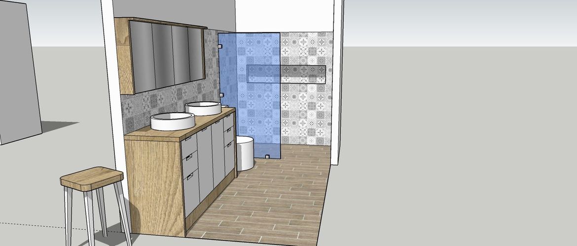

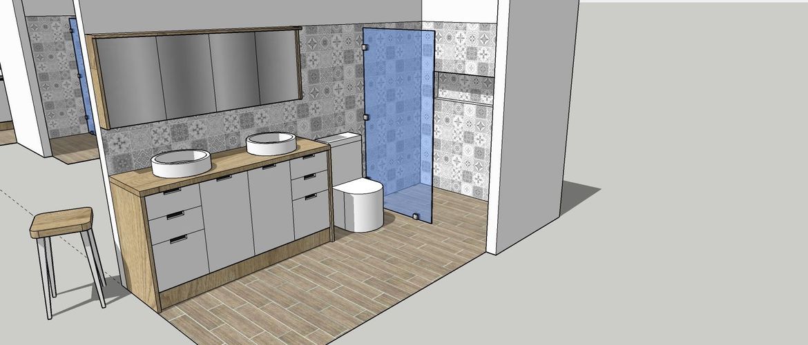

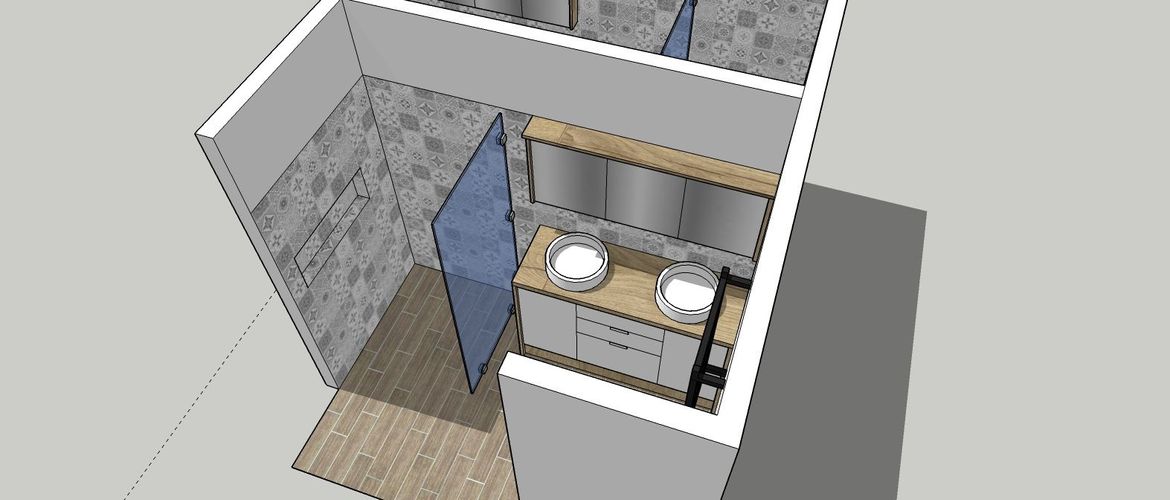

Here's what I have so far.
Hi @shadeli,
Many thanks for updating with your plan and it looks fantastic.
One of the first things I noticed in the ensuite is that you are removing one of the basins, the toilet is swapping to the other side and the shower is being bumped over. Apart from the makeover you are removing one element (the dual sink) and don't seem to be gaining anything. It might just be the plan but the space you have allocated for the shower appears to be around 600mm wide. I would have thought the plus side to removing the extra basin it that you could have a lovely over-sized shower.
I'd encourage you to minimise the gaps in between the toilet, vanity and shower wall to create the largest shower possible.
Below I've shuffled things over to show what I mean. I would be aiming for at least a 1000mm wide shower as it will be far more impressive/functional than empty wall space. I'd be inclined to have the shower where it is and incorporate the toilet area into its footprint also.

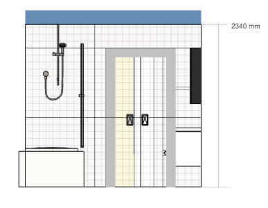

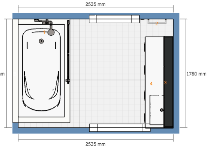

I suggest closing off the second bathroom totally. It makes it a self contained bath/shower area for the kids as you suggested. But instead of closing off the toilet with the second bath, I suggest closing off the en-suite and keeping the toilet in that main shower area. The second bathroom can have its own toilet and not compromise the size of the main bathroom. Have a look and tell us what you think. Good luck, stay safe.
Red
The childrens bathroom.
My apologies it was later on that I realized that the bathrooms dont line up. Not to worry it is still based on sizes that you've indicated.

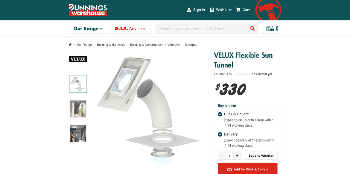

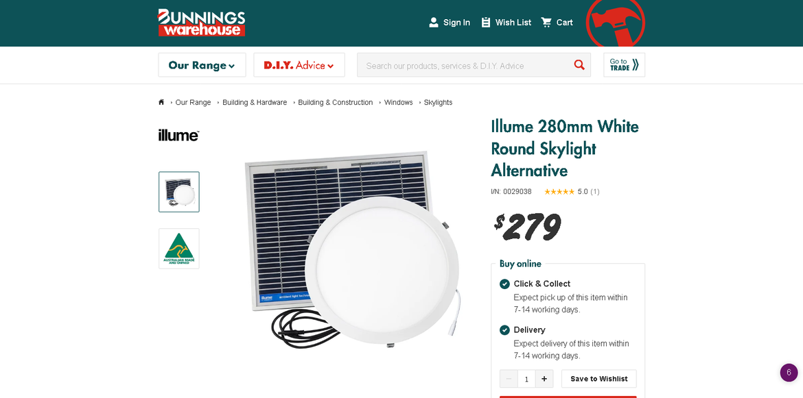

You have 2 alternatives to the natural light issue. One is a natural skylight and the other one is a solar panel skylight. You may google it to see the difference, I shall place pictures of the products below. I suggest getting the services of our In home bathroom renovation designer. They will come to your home and make an estimate of the renovation you wish to make. Pass by the nearest Bunnings store in your area and see if they offer this service. They can then give you a more concrete quote on moving and adding a toilet and anything else you may wish to have done. As for the bath time, I will post a new drawing with your bath placed in, instead of a shower in my next post.
Red
