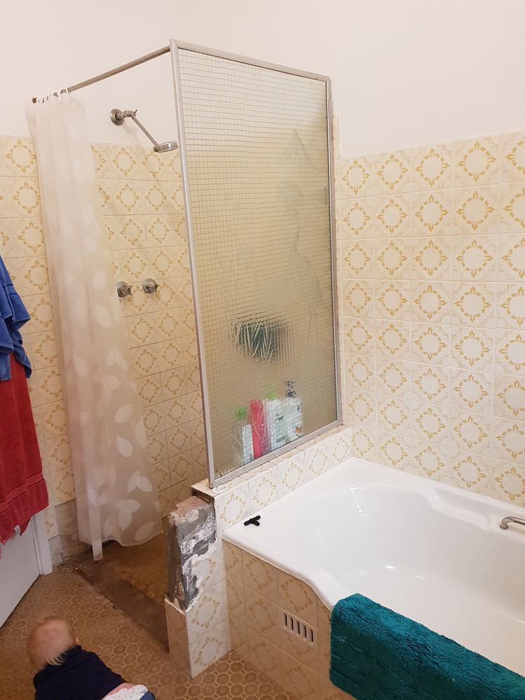

1. How can I make the shower usable? They have removed a few tiles from the floor, or more likely a concrete hob into the shower and you can see the remaining hob is broken also. Whats the best way to fix this shower area (cheaply and easily), knowing we will do a full reno in 3 years. Its on a concrete slab with (from what I understand) no previous waterproofing as the place is quite old. The entire room has been surrounded in brick walls (rest of the house is a fibro cottage).

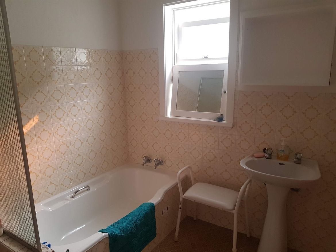

2. Can I paint floor tiles? In the short term, we plan to paint the wall tiles white and put in a new vanity. I'd love to paint the floor tiles also, but have been advised against this in high traffic areas such as bathrooms (as it will just wear and chip away). Would it last for a few years though to get the renters through until a remodel?
3. Whats my best other flooring options that avoid re-tiling (if no.2 can't be done)? Can I just put vinyl sheeting over the existing tiles or do I need to rip up to put down the vinyl? Can I rip up the tiles and just polish the concrete underneath - or does that require a bit of work and still expensive?

If we are on a super tight budget I suggest the following. If you want the plinth back in front of the shower you will have to rebuild it from scratch. A few bricks and a 20kg bag of cement. How ever if you do not wish to build a plinth and just tile over the exposed area, you will have to find either a tile that is similar or very close in color, does not have to be spot on as this is a quick and dirty repair job. As long as the tiling job is clean and smooth and is at the same level as the existing tiles on the floor.  As for the exposed dividing wall take off the existing tiles that are at the bottom and re-tile plain square ones that are of the same shape and color ( or as close as you can ). The key here is to repair the damage and the tiling job must be perfect. I would not worry about water proofing as this is a cement base and is on ground level. Not an ideal solution but is a quick turn around to get tenants in and the house rented. If you do paint the walls with tile paint then tile matching for the dividing wall will not be a problem. However you willstill have to match the floor tile. Good luck and hope your repair goes well.

To save time and money, I would simply render up all your hob area where the tiles are missing.
Is would patch up all the holes and then paint all the walls inside and around the bath in a white tile paint as well as the walls
Even if this was wearing in say 12 months on the floor area you could simply paint just the floor again.
So it would be a simple little bit of labour and materials and it would look very very fresh.
We've done it to a number of bathrooms of 25 years and it makes a huge difference.

Thanks Rob - I think this is what we will do.
I've just bought the tile paint from the new Dulux renovation range so hopefully its good! If it wears down its no problem as we plan to fully renovate in a few years anyway.
For rendering the hob - would you just mix up some cement? Or do I need to use any particular product?
