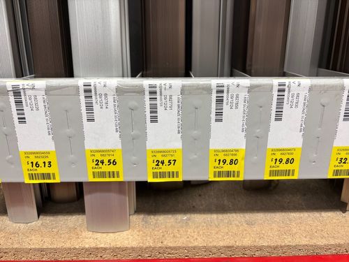

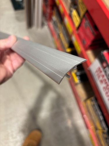

Hello @renie
Let me tag @Dave-1 to make them aware of your questions. I'm not sure how well the paint will hold up in a high moisture environment, especially if it gets wet quite often. I still recommend using the aluminium finish as it has the highest tolerance against water.

Morning @renie
I would have concerns about the paint lasting in a wet area, There are other metal flashings that could be looked into that may have different colours of metal edging. Other then that the aluminium would possibly be the best fo stability of colour for that area.

Hi @renie
Definitely needs to be colour anodised aluminium and not painted for durability. Black would look nicer in my opinion over white. However you maybe able to find a suitable rounded metal  if you can get it professionally cut in the flooring dept in a range of colours.
