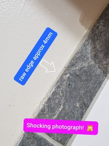

The wall tiles in my kitchen, bathroom and laundry have a very gritty finish. The edges are painted, but the finish might be the raw grout. I'd like to put something on the raw edge that will smooth off the finish (making dusting them easier).

You could apply a couple of coats of Dunlop 250ml Grout Sealer which will smooth out the surface and make it easier to clean. It fills the grout pores and prevents dust and debris from accumulating within them. Alternatively, you could use a colour-matched silicone which would do a similar job.
