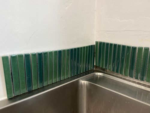

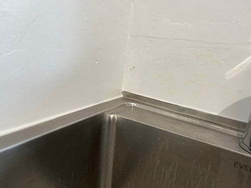

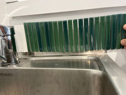

Hi. Am having a go at tiling vertical Kit Kat tiles around my laundry trough. The left side of the top of the trough sits flush with the wall. The back side of the trough has an aluminium lip about 15mm.
I want the tiles to be matching heights from the trough up but am unsure how to achieve this.
Do I need to add another piece of aluminium on the left side wall to match the backing the trough or should I cut the tiles at the back of the trough to be the same height as the left side? My only concern with doing that is the amount of tiles I’d need to cut to then fill the gaps under the window.
It’s not a huge area but this is all new to me! Thanks in advance!

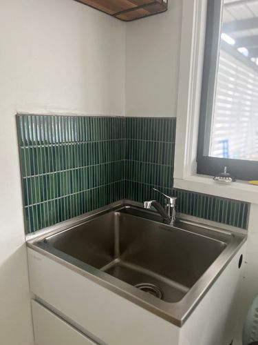

Thanks Jacob. That’s great advise and exactly what we did in the end. Found some 20mm aluminium at Bunnings and used that as the edge around both sides of the trough.
I am pretty happy all in all for my first solo attempt at tiling. Just a bit of tidy up to do as the grout was still wet when I removed my edging tape. Also a tiny bit more silicone to apply.

Hi @SarahK1,
That looks great, you should be very proud of your first solo attempt at tiling.
