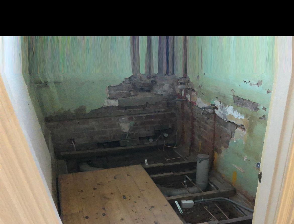

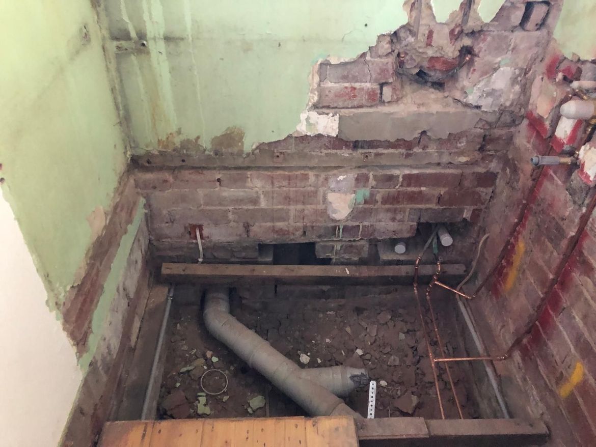

I have talked to a tiler who will do the waterproofing/tiling once the bath is fit out by the plumber. he was happy to waterproof and tile onto rendered brick, doesn’t absolutely require sheeting. i also believe because it is an inset bath, the waterproofing doesn’t require a subfloor under the bath.
i was more wondering about supporting the weight of the bath/person sitting in bath/ water inside bath.
can the bath frame rest on the sill plates and be anchored into brick?
Can I use regular 70 x 35mm framing timber, or should I use 90 x 45mm? Assuming I can use 75 x 3.15mm nails with either option?

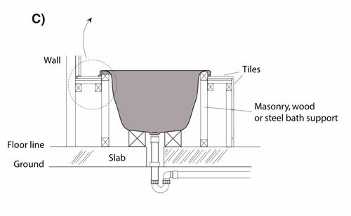

this diagram shows the bath on a slab, but we are not on a slab

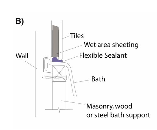

and this shows the attachment to a brick wall, which is what we will do

Technically, it sounds like what you're proposing would work, and 70 x 35mm should be sufficient. However, given that you'll need joists to support the bottom of the bath, I personally think it would be a more straightforward approach to install a subfloor and then construct a frame for the bath on it. If you are installing joists to support the bottom of the bath and have to add a subfloor to the rest of the room, the cost would be relatively minimal to continue the subfloor to the end of the room. Creating a frame on a solid subfloor will be a more robust solution than attaching your timbers to the wall and sill plate.
If you've checked with your trades, and they are happy with your proposition, you're golden. My concerns were that your waterproofer would prefer a more traditional approach, as seen in this guide: How to waterproof a bathtub.
