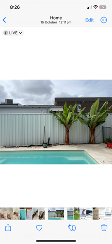

I’ve attached a pic of where the garden bed will go. We are in the process of removing some monster sized ornamental banana palms that are starting to push our fence over after only 13 months growth!
