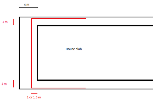

More details as requested:
Top view -
The outer black line represents an existing fence with neighbours. The inner black line represents the house slab. The red line represents what I am currently thinking of putting the retaining walls. The retaining walls on the sides are a gradual fall from 0 mm (front) to around 500-600 mm (back). The entire back retaining wall will be 500-600 mm tall. Ignore the need for stairs for now just for ease of understanding.

Re: Retaining wall close to slab [Melbourne]
Hi @arian10daddy,
Are you intending to fill the area behind the retaining wall up against the boundary fence as shown below, or filling next to the slab to have a 1m space level with it?
I'm struggling to understand what either of those two options achieves apart from creating dual levels in an already small backyard. If dual-levels are your intention and are a design aspect you are going for, then I see no problems if all drainage issues etc are addressed. Once again due to the close proximity to the boundary fences, you might require an engineer to design it.
I assume I am having trouble understanding, as I would presume a better use of the land would be to have the rear portion of the retaining wall against the rear fence, filling the entire area to give you one level 4m space.

Budding Contributor
To answer your first question @MitchellMc, I will be filling next to the slab to have a 1m space level with it. My backyard is deeper than the slab.
Although initially wanting a raised and level backyard, one of the reason for not going all the way to the back fence is that the last 2 m of the backyard is an easement. Would the retaining wall be a "permanent structure" that I shouldn't build over an easement.
The other reason for not going all the way back to the fence is the added headache and expense of screening required to increase the fence height.
@arian10daddy many thanks for the clarification, as that allows me to understand the project further.
Easements can be a difficult issue and I would advise you contact the relevant authority who governs the easement to get clarification on what you can or can not build on or near it. What the easement is for will ultimately dictate what work you can complete. For example, if the easement is for access to pipe works, then building a retaining wall which restricts access to the area would be a decision which needs careful consideration.
I would be of the opinion that a retaining wall would be considered a permanent structure as any rectification work would be extensive.
