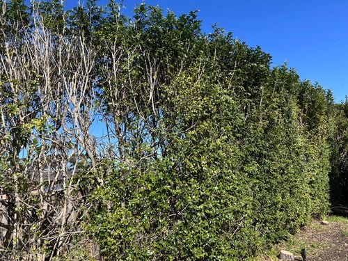

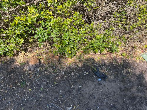

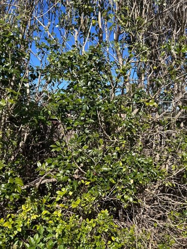

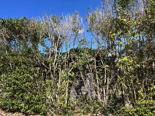

Hi we’ve had these murraya hedges for >10 years. They have always been thriving but in the past 2 weeks we have noticed rapid leaf drop. It is patchy but appears to be spreading. Hedges on the opposite side of our driveway are fine. What can we do? We haven’t mulched for some time, and recently had robinas cut down (6 months ago) but there is leaf drop even where we did not do this.

Examine the soil around the base to determine if it’s consistently soggy or very dry and consider whether nearby tree removal may have disturbed roots.

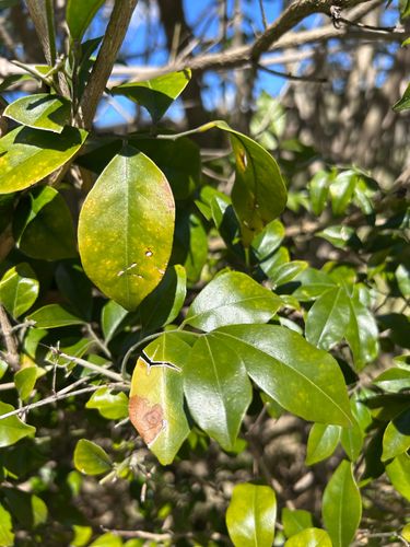

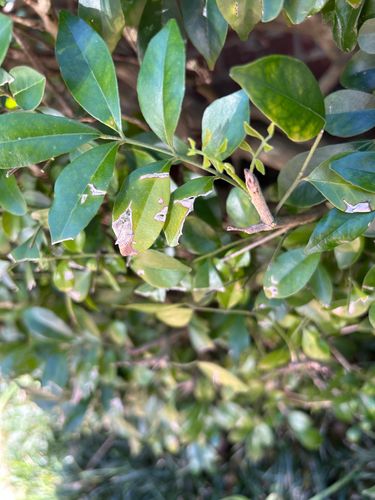

Thanks @JacobZ ! The problem appears to be spreading rapidly. I cannot see sooty mould, or signs of fungus. However I do see brown patches on leaves and on the other side of our driveway another hedge is now affected but there are white patches. I have tested the pH and it’s 8.5. Is adding sulfur going to do the trick or do I have something else going on like a pest or disease?

From the photos and description, it looks like your Murraya hedge is under stress from a combination of environmental and possible pest or disease issues.

Second, the leaf symptoms. The brown patches and uneven yellowing suggest more than just pH stress. On closer inspection of your second hedge with “white patches,” that may point to scale insects. Citrus leaf miner is another common pest in Murraya that distorts and discolours new leaves. Scale insects often bring on secondary sooty mould, but you said you have not seen any, which means it could be an early stage.
It is worth checking the undersides of leaves and along stems for small, flat or domed insects. If present, Bunnings has several suitable control options including Yates 750 ml Ready To Use Scale Gun Insect Pest Killer for immediate knock-down, Yates 500 ml Pest Oil Concentrate for larger hedges, or Seasol 1 L EarthCare White Oil Insect Spray and Multicrop 1 L EcoPest Oil Insect Spray for a gentler white oil approach. These oils smother pests like scale, leaf miner, and mites, and are best applied in the cool of the morning or late afternoon.
Third, the rapid defoliation suggests that the plants are already weakened. Stress from the alkaline soil, possibly made worse by dry conditions, is opening the hedge up to secondary problems like scale, leaf miner, or fungal leaf spot. Some of the brown blotches on leaves could indeed be fungal, even if you are not seeing mould on the surface yet. Consistent deep watering and the addition of mulch will also reduce stress and improve soil health.
To tackle this, I recommend three parallel steps. First, begin soil correction gradually with elemental sulfur products such as Manutec Sulfur Fine Granules or Yates Soil Acidifier Liquid Sulfur and mulch with organic matter. Second, apply a balanced liquid feed with trace elements to give the plants a quick nutrient boost and offset the effects of high pH. Third, carefully inspect for pests such as scale or leaf miner and treat with one of the horticultural oil sprays mentioned above. Avoid overfertilizing with lime-based or high-alkalinity fertilisers, as that will worsen the problem. Ensure consistent deep watering rather than frequent light watering, as drought stress can accelerate leaf drop.
