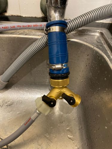

I am trying to connect a water supply to a bench top dishwasher. This is a non-threaded tap which is why I had to buy this connector.
When I turn it on to the side without a hose, the water flows perfectly without the connector coming off the tap. However, when I turn it on to the side with the hose attached, there is too much pressure, the water sprays everywhere, and the connector falls off the tap. I wonder if something in the hose is blocking the water from coming through.
When I look through the water supply hose, there is a filter that I think is causing little water to flow through and causing the buildup in pressure. Is there something I am suppose to be removing? How do I make this work without the connector coming off?
This is an old home where the water supply is behind the walls rather than under the sink, which is why I have to connect the water supply via the tap.

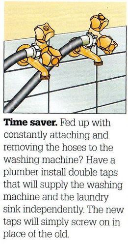

I believe the filter in the hose isn't the problem - as you say, its that rubber connector and metal band on the old style tap. You simply can't tighten it (too tight and it will tear) enough to handle the water pressure.
Amateur suggestion - get a double tap installed? (I googled Double Tap - and most hits were Zombieland 😁)
Double TapDouble Tap
