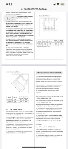

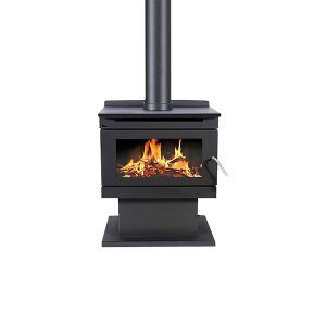

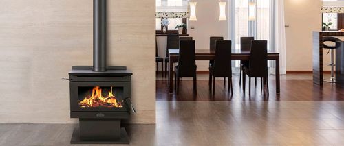

We have just purchased a wood fire place and we need a hearth. Does anyone have some guidance with how to make a polished concrete hearth for this one. I have attached the pic and dimension etc.
could someone also confirm the size of the hearth I need to build.

As far as I can tell, the size of the required hearth is not specified in your instructions. In order to work it out, you'd need to know the depth of your heater. The width of the hearth will either be 900 or 1000mm, depending on your model, but the other dimension would be B (300 or 400mm) + X (125 or 175mm) + the depth of your heater (marked with blue arrows).
