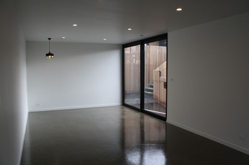

We've gone with a polished concrete floor in our new backyard games room @ShawnWilkey. We're happy with the look and feel. We're finding it surprisingly warm underfoot.
I take it you are thinking of polishing an existing concrete slab? If you were putting down a new floor you could obviously investigate in-slab heating.
I think for a family room you would also want to consider a rug, especially if its an area in which family members typically sit on the floor such as when watching television or playing games. But you would probably want a rug anyway even if you went for timber or tiles.
I'll pop a photo of our floor below. Hope it helps.
