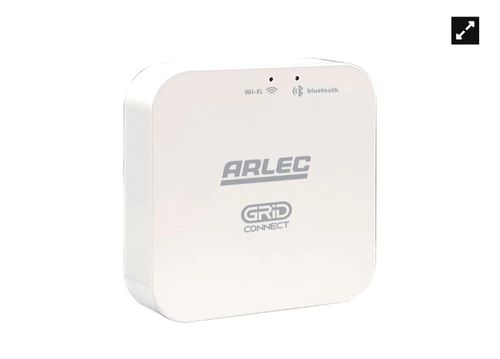

If so then they require a bluetooth hub like so.
Which used to tie into the Bluetooth mesh system for these devices.
Now you can either return the sensors as you will more than likely have a hard time finding that Bluetooth hub as it was phased out but you can check your store where you got the sensors from and you might be lucky.

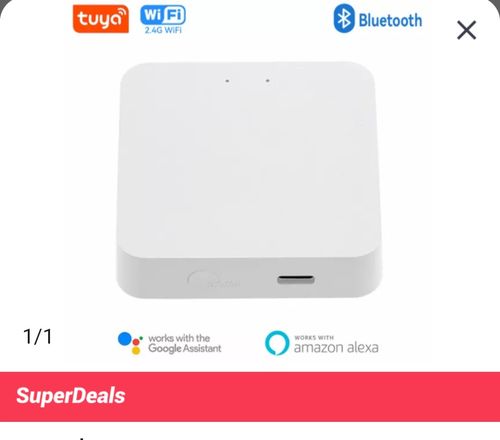

The 3rd option is you can turn to Aliexpress and purchase either a straight Tuya bluetooth gateway or a Multi Tuya bluetooth/ Zigbee gateway and this will intergrate right into your Grid Connect software. The advantage if having a multi gateway is that Zigbee creates its own mesh which doesn't cause pressure on your wifi system.
Now zigbee devices are not available for Grid Connect in Australia but there are plenty of Tuya compatible zigbee devices available through Aliexpress just be aware that any mains voltage devices are NOT compliant to Australian Standards so battery /usb only.
