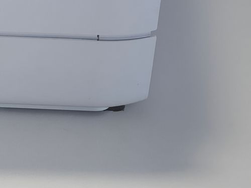

So I ended up scrapping the slab idea and just had them mounted to the wall, however have another question:
In one of the AC's the hole in the wall is visible
It's my study and I sit under the unit so am constantly looking up at it. (see below)
Is this an acceptable installation or something I should complain to the installation company about? I dont think I could patch it myself as it would probably require taking the AC off the wall which I would not want to do for fear of damaging pipes ect.
Re: How to lay a concrete slab for air conditioner?
That's quite unsightly @robjow. I'm unfamiliar with construction codes stipulating this hole must be sealed, so it probably depends on whether you are happy with the installation. It certainly wouldn't hurt to call the installer and question the visibility of the hole, as typically, the actual unit itself would cover any holes in the wall for routing pipes.
I would certainly advise against you trying to remove the unit from the wall. In the worst-case scenario, you could likely fill the gap using paddle pop sticks to apply the filler; tedious work but doable.
