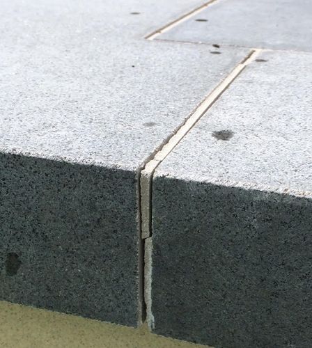

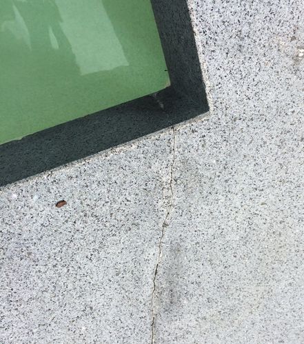

We've had large cracks develop in one of our corner pool copers since the stone was laid about 12 months ago. And in a couple of others the mortar has cracked and/or fallen out from movement. After we complained, the paver that we hired said six months ago that he would order a replacement corner coper and chaulk the gaps. We're still waiting for him to return... Is there a body that I can complain to about the quality of the paver's work? Really keen to get the problems rectified and don't feel I should have to pay someone else to fix them...

Firstly you will need to identify what's caused the cracking
Generally they are flexural or tensile cracks or poor compaction,etc,etc
Is your pool concrete or fiberglass?
Please provide more info and photos to help others as it's a common fault

Thanks. It's a fibreglass pool. I took these six months back when I reported the issue to the paver - they are bigger now and there's a few others now that aren't corner copers where the mortar is cracked and/or falling out.

Update: finally got the paver back! Maybe complaining here helped!
He replaced the cracked coper and removed all the cracked grout, replacing it with flexible chaulking. Hopefully that's durable in the long run...
