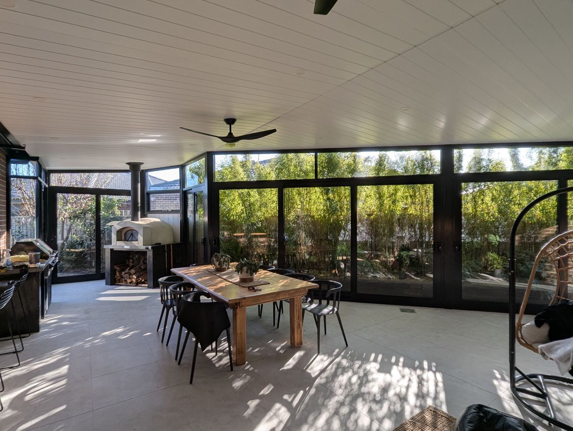

We had a window installer insall a heap of sliding doors and windows and it all looks great however after about a week after he finished and we paid him I noticed he missed 2 sections of caulking between the glass and the aluminium frame which is exterior
He used the DOWSIL product
Ive tried to call him but he doesnt answer or return my messages as typical tradie form after being paid. I did have alot of trouble getting him to finish the job in a timely manner so I dont think his coming back
So as its just 2 caulking spots ill just do it myself
But I can only find this stuff that is an equivilent but its clear. I need black
https://www.bunnings.com.au/parfix-300g-black-window-and-glass-silicone_p1230051
any suggestions? Otherwise ill have to get the DOWSIL one
btw check out the picture
